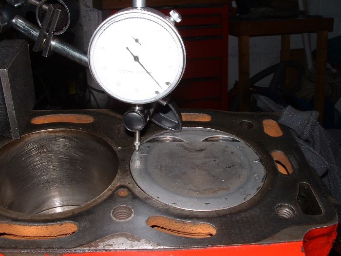

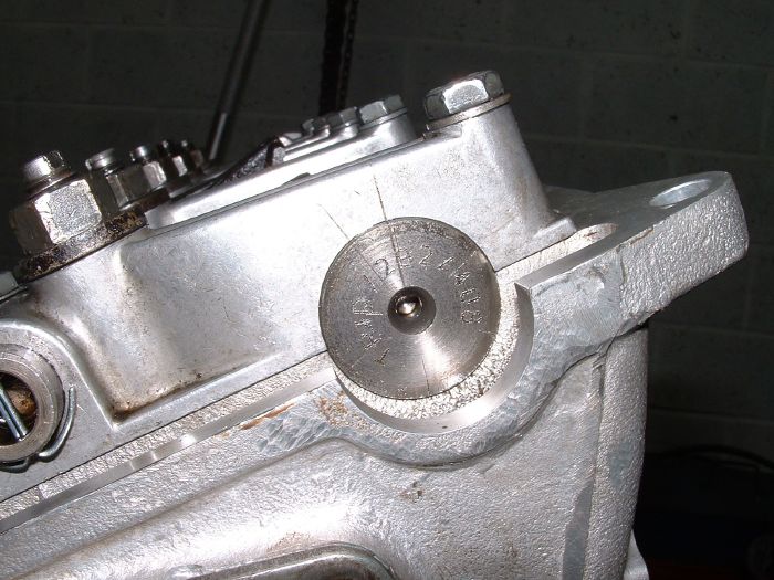

I was thinking about having the head skimmed but I just couldn't throw any more money at it.
One think the machinist told me was if I had the stud holes counterbored it would stop the head from swelling around the holes, as the angled studs push against the head. You can just make out the swelling in the bottom pic. Luckily on mine it is very slight.
Re: Track Sprint Resto
That's caused by wrong tightening sequence.

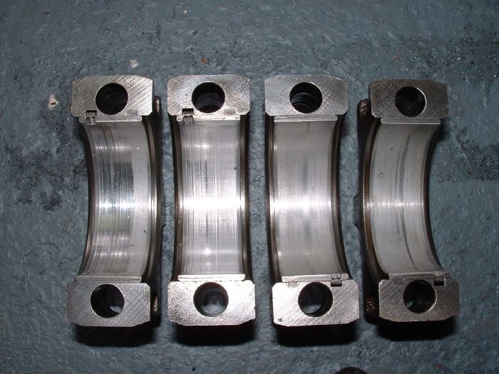

Finished the valve clearances first thing, just one shim needed, which I can pop in at a later date as it's an exhaust shim.

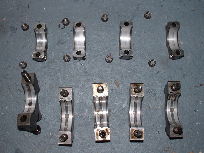

I thought I'd better check the bearings whilst I had the engine out. Mains were ok but the big ends needed replacing...

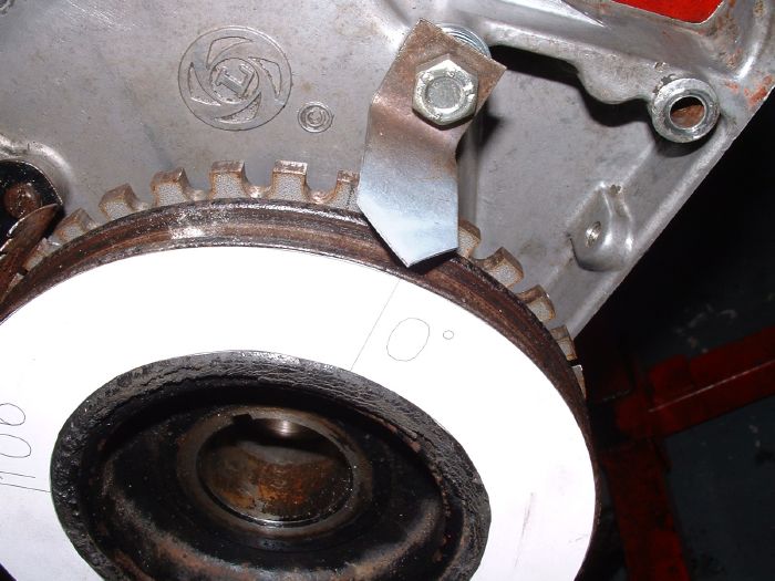

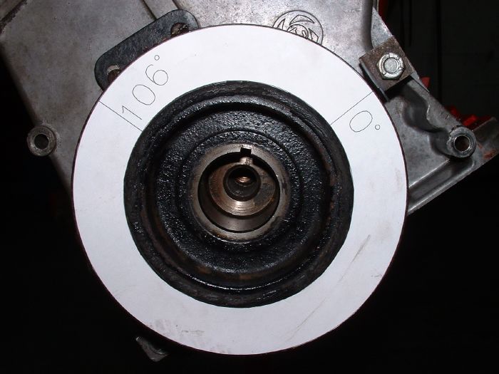

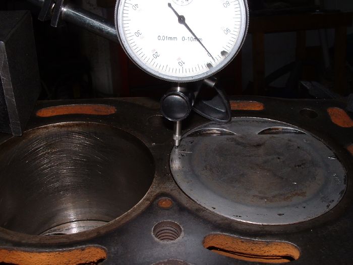

Finding TDC...(that's Top Dead Centre not Triumph Dolomite Club
Once TDC is set on no.1 cylinder I bolt a pointer to the front cover then stick my timing template on the crank pulley to align with the pointer at 0 degs....

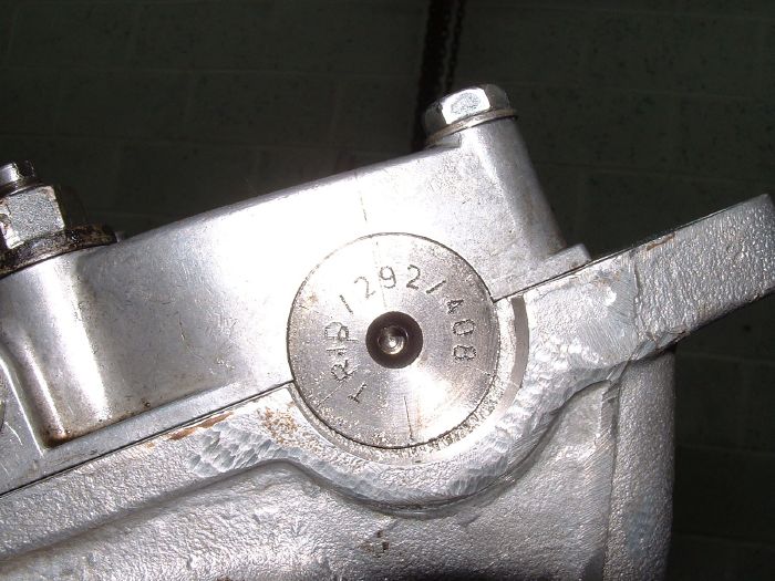

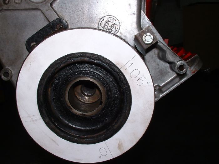

Then I rotated the crank to line up with the 106 deg. mark. This is the installation figure for my cam, Newman cams TRID-292-408 (TT10106 equivelent)...
Next thing to do was to set the inlet valves on no. 1 cylinder to their fully open position. Because I've set this cam up before I was able to use the marks I'd put on previously, so no need to use the dial gauge...

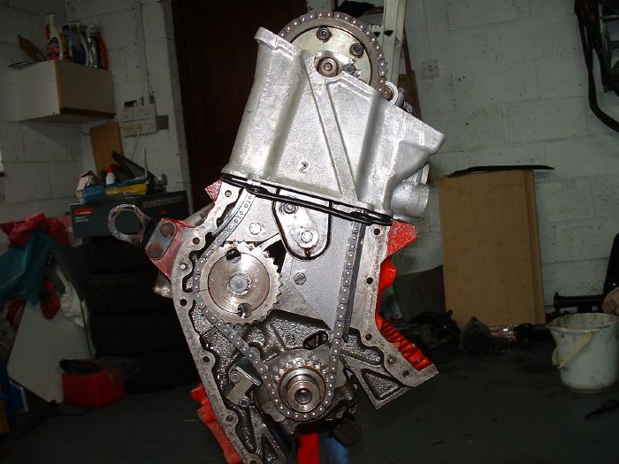

Then I fitted all the timing gear, making sure the run of chain on the right (as you view it) between the crank & camshaft was taught. There was a small amount of play but this was taken up using the vernier cam pulley.

Dan, when you set up the timing chain all the slackness is taken out with the curved guide (on the left). the tensioner is only there to take up any slack as the chain stretches over time.

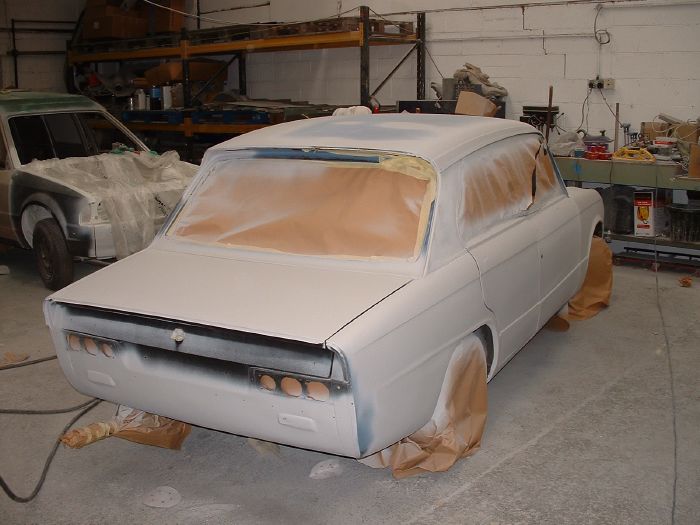

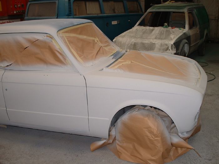

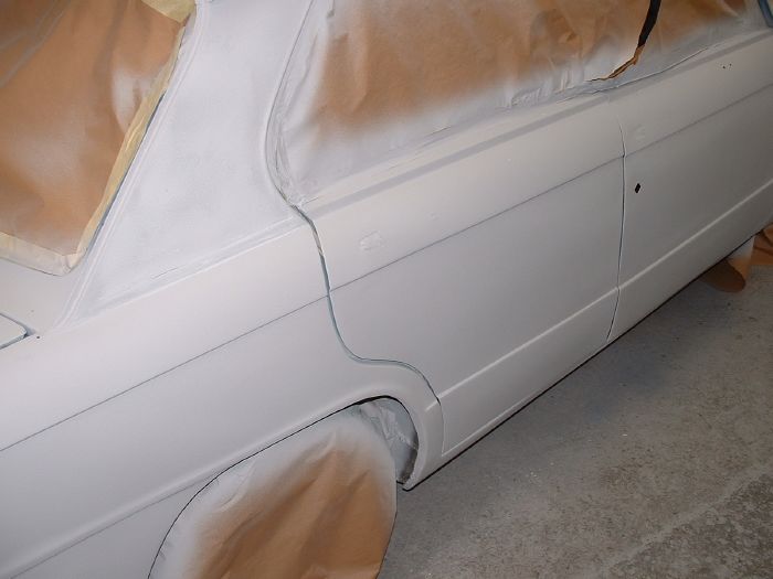

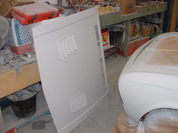

A bit more progress. I went to visit PKN in the spray shop this morning...
The rear wing & passenger door look a lot better than they did...

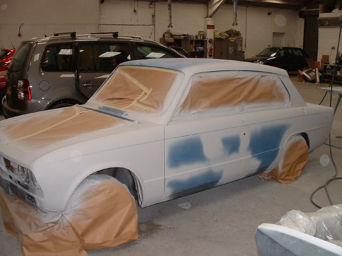

Hopefully by this time next week there should be some green paint on it.......but where?

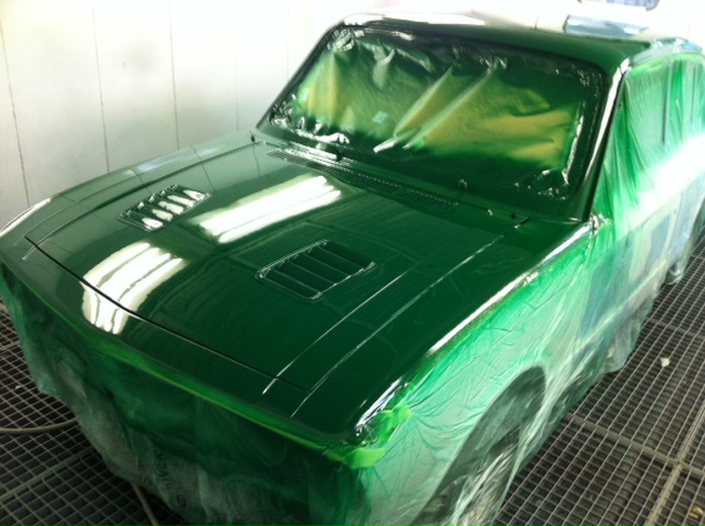

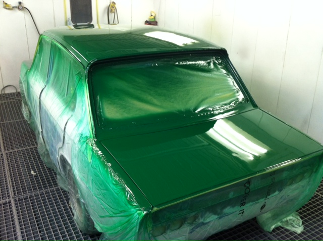

Well I just got a nice surprise, Jon just emailed me a couple of pics from his phone...
