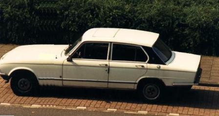

#7 Post by soe8m »
Here's a picture of it.
