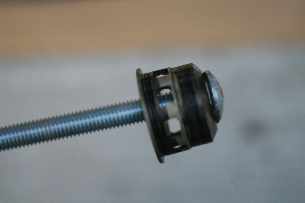

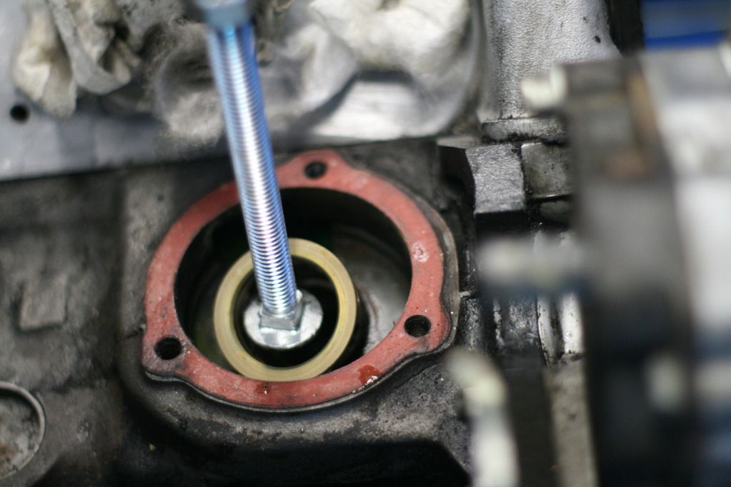

Usually getting the pump out isn't the biggest problem, the brass cage can be a bit of a pain to remove.
Easily solved with this simple tool I made of bits lying around in the garage ...

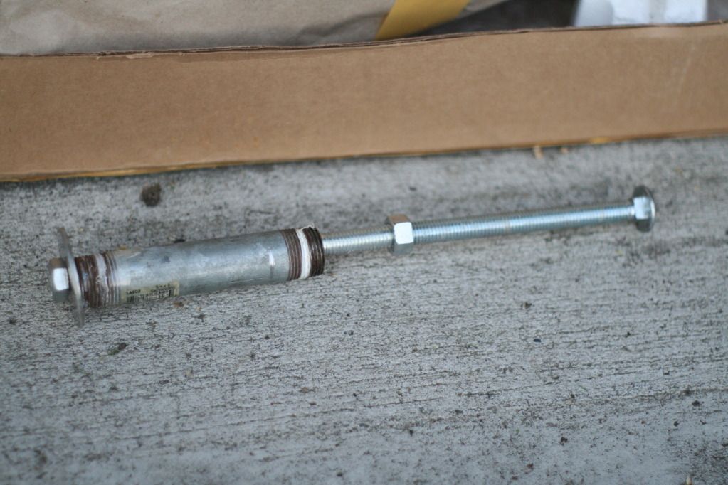

#7 Post by Mad Mart »
Similar to mine...

Beans your kit looks beautiful, as always.
I made one out of garage junk very much like Mad Mart's and it worked perfectly.

Typically "b' will happen; so I then put a larger washer under the bolt and threaded it back in. That gives you more to pry up on if you don't have a slide hammer. But its easier with a hammer, even if you have to make one up. I made a simple slide hammer out of old plumbing parts and bolts.
My pump came out easily, so all I had to do was get the brass cage out. I used a 1/2" carriage bolt at the bottom of the slide hammer. You can insert that through the cage, hook the bottom and tap it right out.
