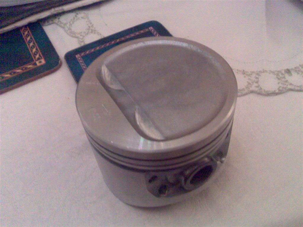

Just stripping a spare engine this afternoon. Whipped the head off to reveal dished pistons ! Anyone seen these before ?
The head has a 16VT14 camshaft. I'm puzzled because it has a 'standard' cam sprocket and the crank and cam timing marks line up. I thought the cam timing was different with performance cams. There is a second timing mark on the crank pulley. Would this be where the spark plug is actually firing ?
The dish shape on that piston is the same as mine but there are no cut outs for the valves. In fact there are marks on the raised flat area that must have been made by the inlet valves. Odd !
Carl wrote:The dish shape on that piston is the same as mine but there are no cut outs for the valves. In fact there are marks on the raised flat area that must have been made by the inlet valves. Odd !
might be low compression Tr7 pistons .... for the yank market.
