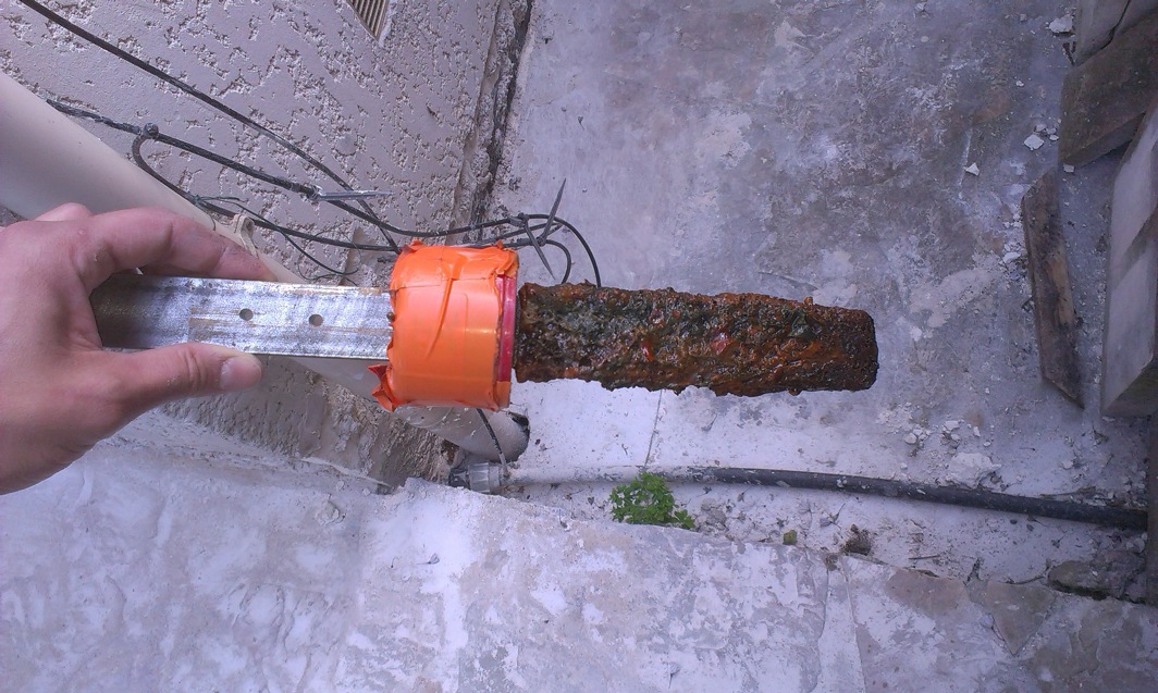

Here's some some feedback for electrolysis in the fuel tank.
At first I had used a coat hanger to dip into the tank and collect the rust, but ater the second day of treatment the coat hanger had been completely eaten by the electrolysis so I replaced it with a much thicker piece of metal.
As you can see a LOT of muck came off! I left it working for about 5 days cleaning it everyday, this is the result after one day.
The process is really effective as you can see, but rust spots reappeared like 30mins after even though I rinsed it with alcohol and dried it thoroughly, a lot less of course, but so I'm unsure wether I should use tank sealer on top of it or I can just go with those rust spots and fill it up, what do you think?
Also what method do you use to clean the fuel pipes? Given what I had in my tank i bet the pipes could do with some cleaning too!
