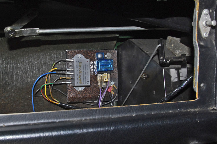

#13 Post by Robert 352 »
For those of you who hanker after an intermittent wipe operation on your Dolly then I can report that the Smartscreen controller works very effectively.
Yes it is considerably more expensive than the kit of parts referred to elsewhere on this thread but the Smartscreen controller does I think offer a couple of functions which these kits do not.
The intermittent wipe facility is activated by pulling back on the intermittent wipe switch on the steering column and the delay is set by how long you take to pull back on the switch for a second time. From then on the intermittent wipe will repeat itself until you pull on the switch for a third time (or turn the ignition key off). It is all quite cunning and becomes quite instinctive once you have used it several times. There is no need for any additional switches nor is there a need to have some device to set the timing delay.
I installed mine behind the glove box on a little panel which I have made up to hold the relay which switches on my "overdrive on" light. The photograph shows it sitting on the bulkhead just to the left of the heater box, with the wiper arm above it and the microswitch on the right which is used to spring the glove box lid open. All of this is hidden once the glove box case is refitted.
20140816-4867Pw Smartscreen installation.jpg (131.77 KiB) Viewed 2377 times
The feed comes from the live side of the brake light switch on the brake pedal. I pulled one of the connectors back out of the wiring harness which feeds up the steering column to the wiper switch (all done according to some very comprehensive instructions provided with the unit), made a further connection via a new connector fitted into space vacated by the connector I pulled out and the third as per the instructions.
Not too difficult even for a simple soul like me.
