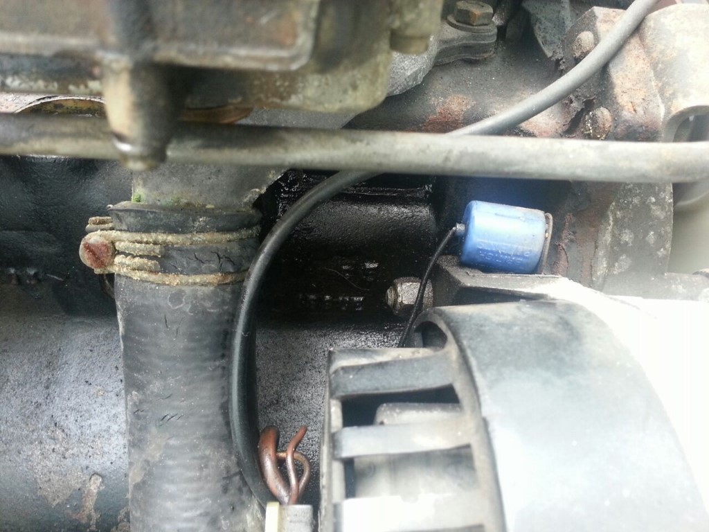

Hi All
As per the title I have an oil leak on my engine which is coming out at a fair rate, i have attached some pics below, it appears to be coming from under the water pump housing, i dont know what is under there can anyone enlighten me ?

The oil is coming from the water pump vent slot which would imply the oil seal on the bottom of the waterpump is kaput. Its less common than failure of the waterpump gland seal that lets water out from the same place, but it does happen! My condolences sir, you are going to have to overhaul the water pump to fix this!
Posts: 2284
Re: UNKNOWN OIL LEAK
#3 Post by tony g »
Change that cracked hose too! :)
