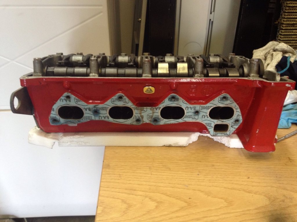

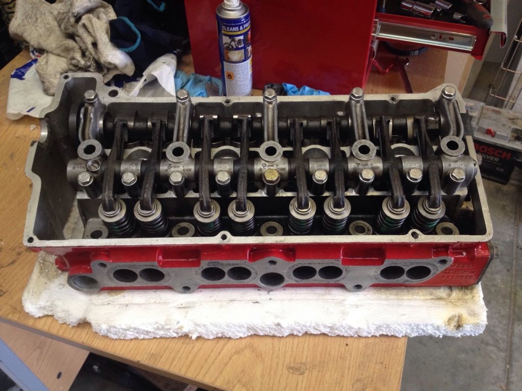

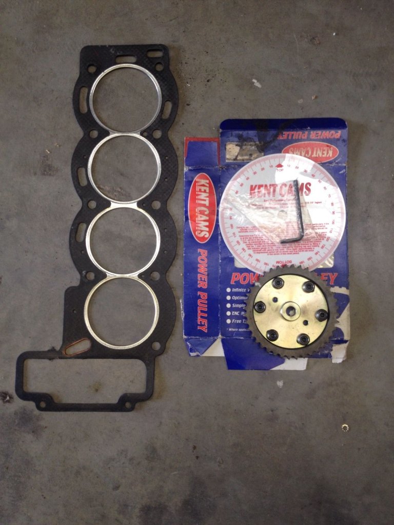

The parts I just bought. A rebuilt cylinder head with fast road lotus camshaft.
Kent Cams S43 Vernier adjustable camshaft power pulley and timing disc.
Rebuilt skimmed cylinder head with Lotus profile camshaft (Lotus 907 - L14 spec.), uprated Kent single valve springs, standard valves, new camshaft bearing cap and pedestal bolts, new inlet bucket tappers, new exhaust valve stem oil seals etc.
The head has no serious corrosion or warping and has been fully decoked.
New correct spec. thick head gasket

Nice head rebuild. Can I guess where the Lotus badge came from ?.......... :)

I paid £325, fair enough if you ask me. A new cam and vernier would've cost more. The only thing I'm curious about is how well the porting and skimming is done...

Interesting head! Spoke to Jeroen last weekend, he advised to skim the head slighty slant (what's in a name...) to stay clear of the valve seatings. He also mentioned a hotter cam being a lot more effective if it's accompanied by a higher compression ratio.

Very interesting head, Henk. I was searching on eBay for a camshaft, but found this instead. I'm not completely sure if the revision is done thorough, but luckily my dad knows a lot about engine tuning. Jeroen also advised to check if the compression chambers are equal, so we'll see. In Q1 it should be up and running again...

Henk, that is an 1850 head. A sprint is supposed to be straight skimmed. To have the best result an 1850 should be skimmed slant to save the valve seats and to have the most out off the combustion chamber. The only thing is you MAYBE have to drill out the angle stud hole 1mm because the studhole does not line up with the engine block.

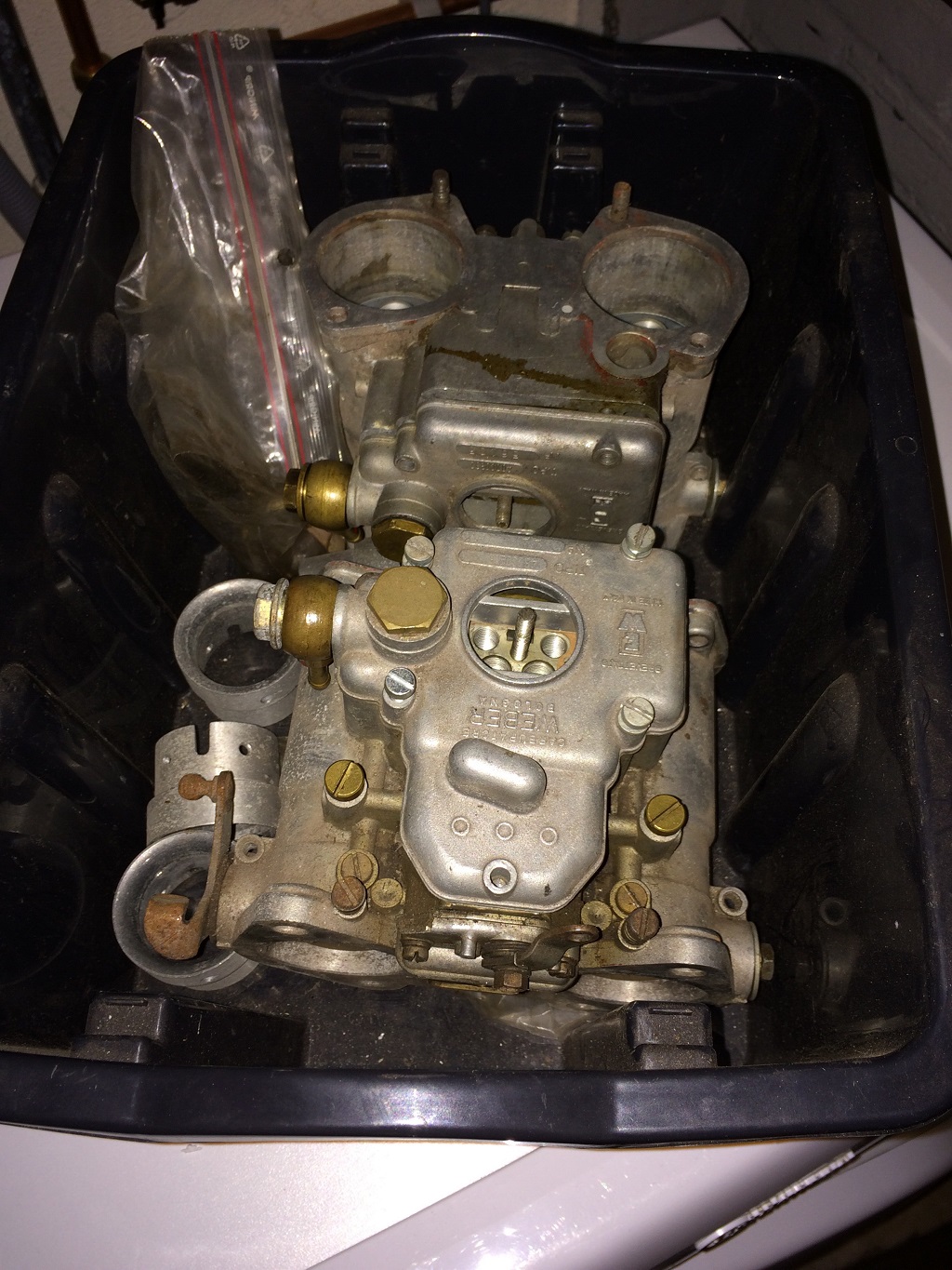

Well, looks like I will be making a start tomorrow. The Sprint is moving to my parents' garage, where I have the equipment to get the job done. Forum member and fellow Dutchman Soe8m adviced to start with optimizing the engine before doing upgrades. So that's what I'll do first, after the engine is out. In the meantime I'll clean the set of 45 Webers I acquired.
