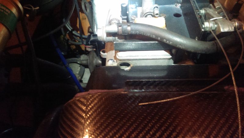

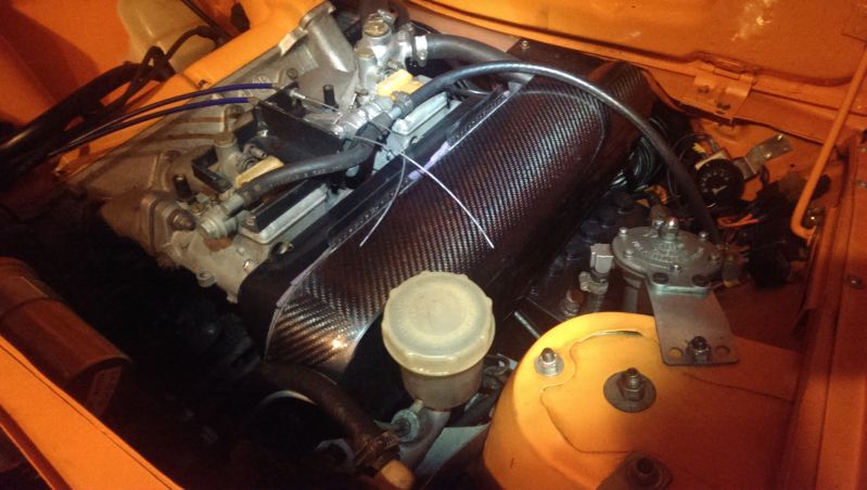

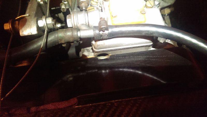

Here we go, here are some pics that I took last week (delayed upload due to photobucket problems, so apologies for that) -
Here is the complete set up. Deep backplate, customised carbon box with cold air feed leading to snorkel pointed to the front of the grille.
Thanks all for your input.
