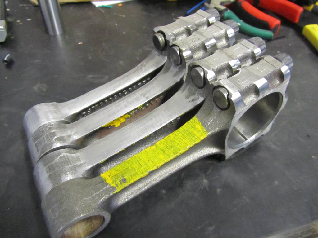

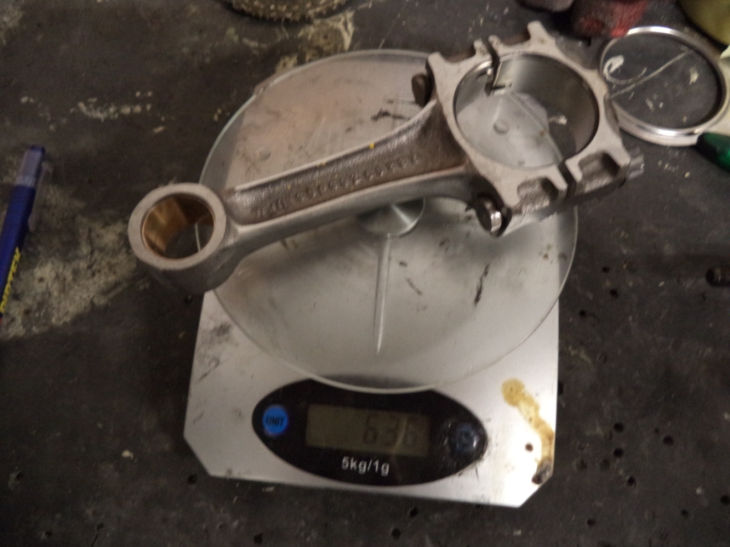

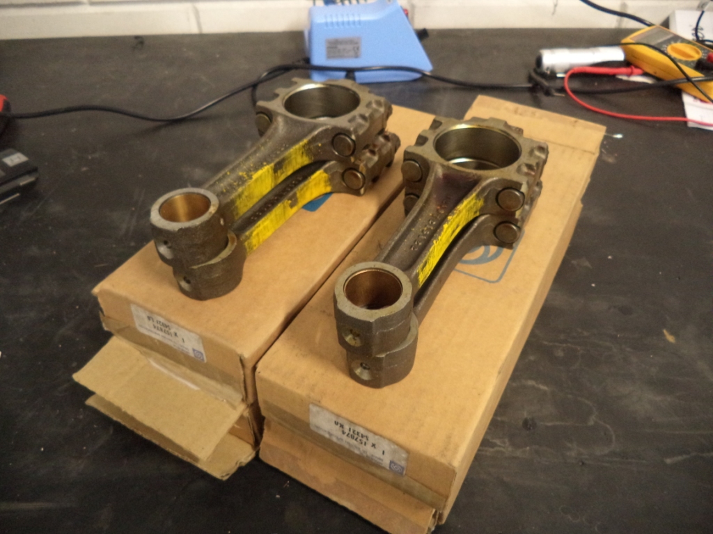

Tonight was conrod night. I'm selecting 4 conrods that have about the same weight. It can varie 30 grams per rod sometimes in an std engine and that is way too much. The next pictures are the basic lightening of the rod. As new rods don't have a mark in them i stamp my initials in them for not mixing up. :D
The start is with the bearingcaps. When you are having these the same weight it is easier balancing the rotating and translating weight later. Then lightening the small end but don't forget to re drill the oil collecting hole. Otherwise the piston pin has less lubrication. The next step is to have all the rods less cap the same weight. This is the basic lightened rod. Next week i'm going to balance them. In the last picture of an old rod you can see where to take some material for final balancing. When all is done it's rounding the edges and shotpeen all the grinding scratches out.
Re: Start of another new project
#9 Post by soe8m »
#10 Post by soe8m »

#12 Post by soe8m »
All balanced and ready for shotpeening. Next step is putting the o/d together and wait for the engineblock and head to arrive from boring/honing/skimming. After some calculations it isn't possible to have a 1:13 compression ratio. 1:12 is max. The combustion chamber is not that much smaller than a tr7. I'm having the deck skimmed so that the pistons are 0,75 above the deck and use the compressed headgasket thickness as extra space to decrease the combustion chamber volume. The head isn't skimmed under an angle but max straight. This will be about 0,5mm. This way the valves have enough clearance.

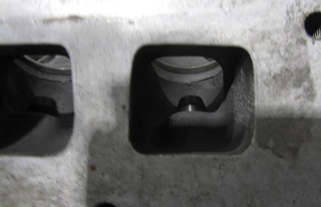

The 1850 head is max skimmed and ready for some enlarging of waterholes and ports. The ports are not going to be widened only smoothened and matched with the manifolds. The ports cannot be enlarged much. They are close to the water jackets i discovered a few year ago. An internally cracked head was a water drinking engine mistery. All the inlet port holes had cracks into the watersystem. :oops:
The combustionchambers have still to be matched also.
The guides are replaced and the inlets machined to have less resistance so slightly better flow.
