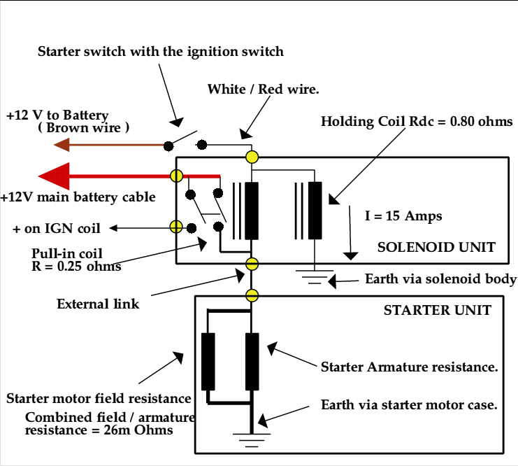

PAB wrote:Thanks for the suggestions I've tried it with my jump starter and it makes no difference though. Grinding is perhaps the wrong way of describing it, more a very fast loud clicking. Battery is now on charge, but I don't hold out much hope.
This is a good description, as it says exactly what is happening. The pull-in coil on the solenoid is working fine but there is a subsequent problem, that then causes it to drop out, and the volts rise and it pulls in again; probably one of the problems below.PAB wrote:Thanks for the suggestions I've tried it with my jump starter and it makes no difference though. Grinding is perhaps the wrong way of describing it, more a very fast loud clicking. Battery is now on charge, but I don't hold out much hope.
* High resistance on the battery connection.
* Holding coil in the solenoid faulty ( not holding the solenoid in ).
* Faulty segments on the starter solenoid ( pull-in coil puls in, the starter just starts to turn but drops out when it meets the faulty segment )
* High resistance on the brown wire to the ignition switch. ( Pull-in coil works initially but drops out when high motor current is drawn. ) . Also applies to the thick white/ red cable and that link plug down by the gearbox.
* Faulty ( high resistance ) battery.
Here is a sketch of the starter electrical system.
HTH,
- starter.png (21.72 KiB) Viewed 1312 times
