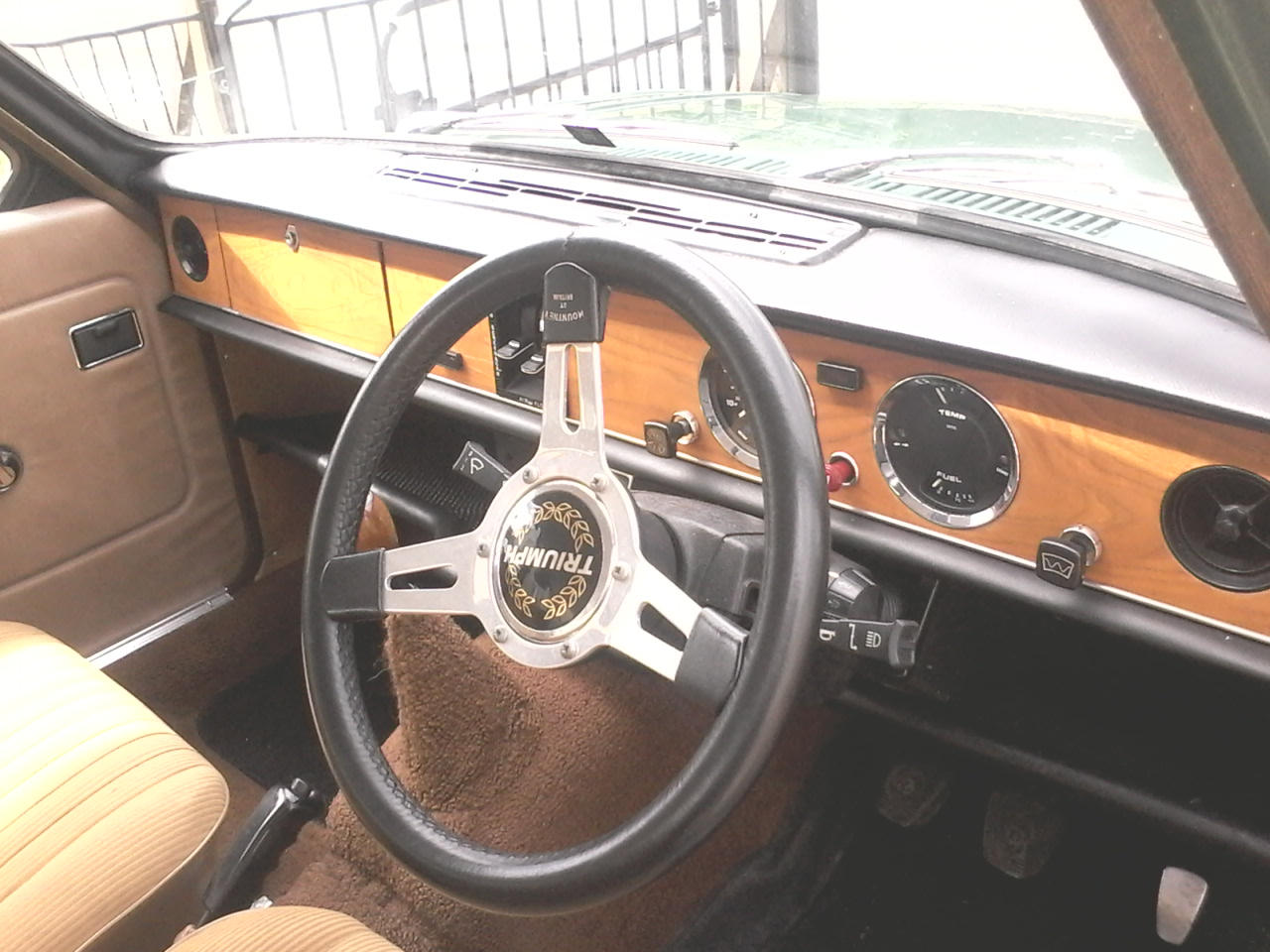

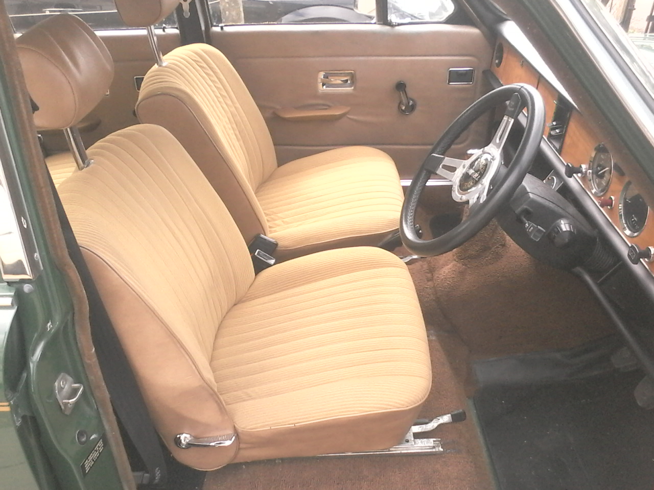

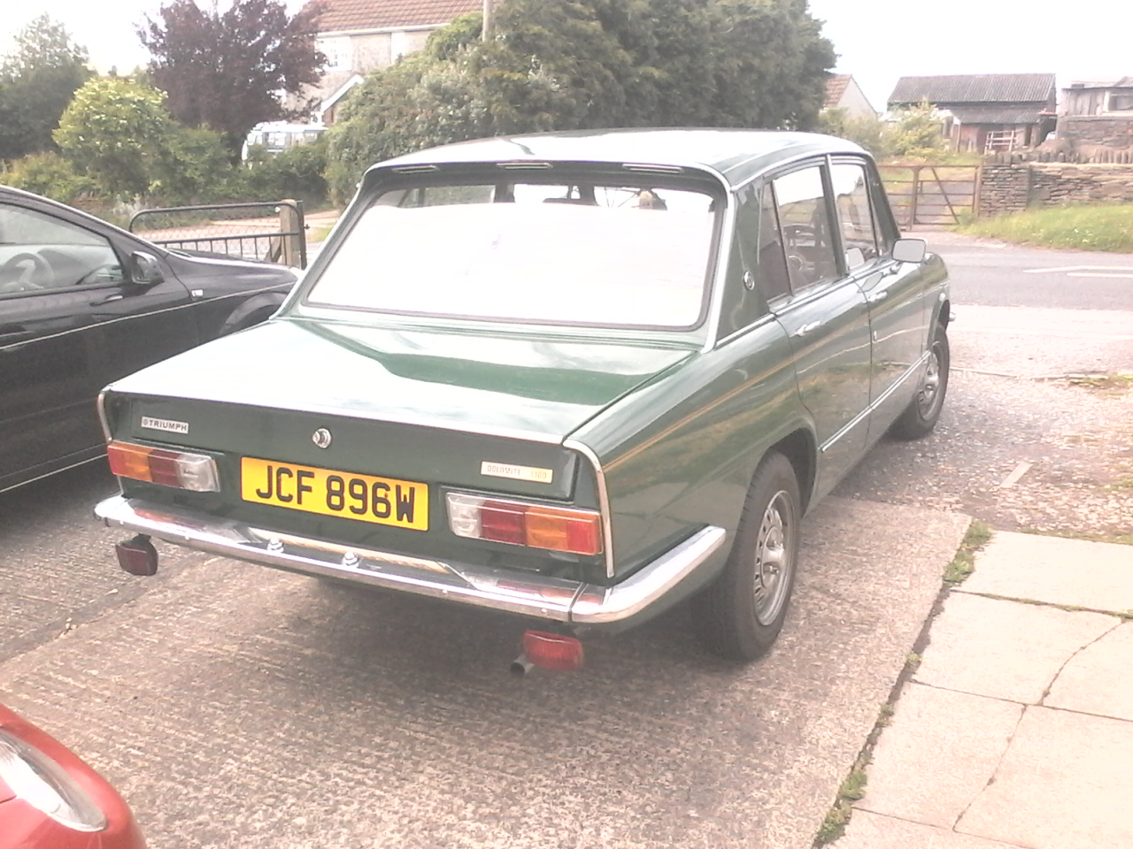

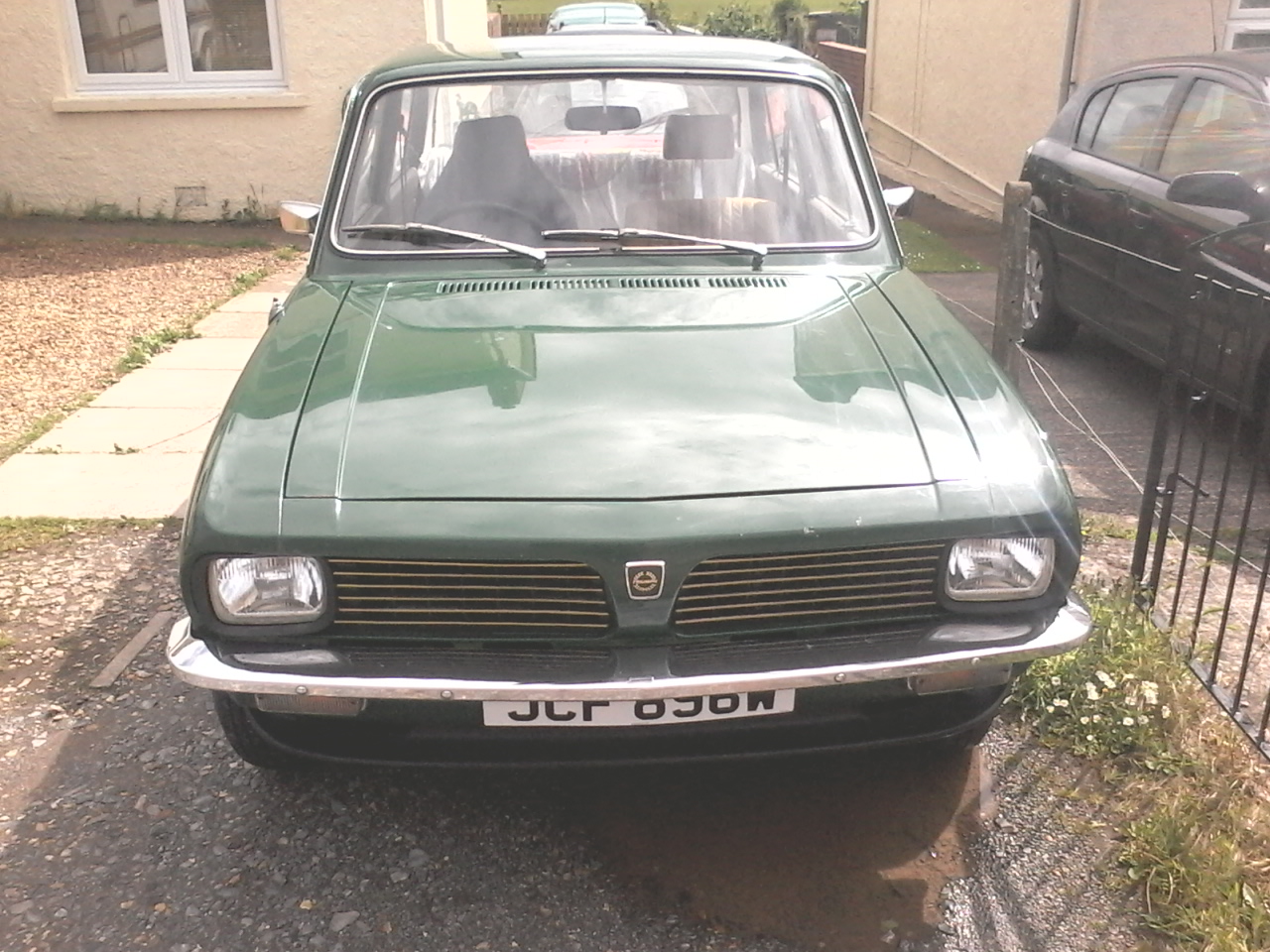

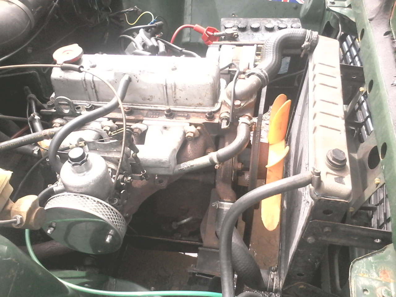

A few photos i have taken now its moted and clean.

That looks utterly wonderful...!!!
Well done for saving that gem...
