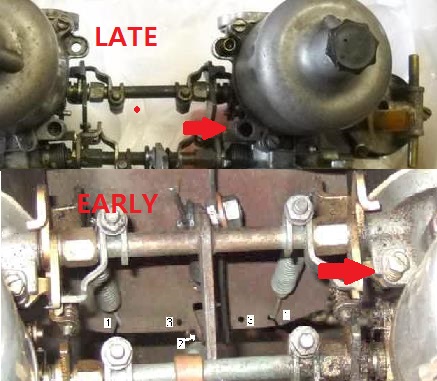

Hi Henk, FZX1265 is listed as an 1850 carb; setup from engine number WF67919 ; so quite a late one.
Looking at the pictures it also looks like a waxstat set-up with £!!! ??? prices.
It looks like the jet to float chamber o-ring seal is not supplied separately which I find surprising
as this is the most likely failure point.
So it looks like you need 1850 waxstat jet assembly front carb; WF 67919 ---> LZX1323A £43

Tony, I concur with the leaking point. I really doesn't seem to be the connection to the float chamber. I cleaned the jets yesterday so probably the traces of the fuel are better visible. In my opinion the leaking point is just below the adjusting nut.
I saw the high prices of a jet, but a car in flames will be more expensive. Strange thing is the late type carburettor while my car is from 1974.

Easy to identify. Tabs can be switched.
Re: -urgent- leaking carb jet
Thanks, that's sorted then: late type it is.
