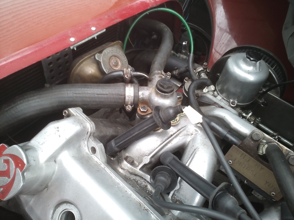

Another problem I have is the thermostat housing has almost been eaten away and the narrow pipe up to the header tank was blocked and I would like to replace it as it's leaking. Can't get one from Rimmers anyone know where I can get one?

- Thermostat Housing. The stub has rotted away
- thermostat housing.jpg (277.84 KiB) Viewed 3069 times

Your thermostat housing doesn't look too bad? I have sent you a PM nevertheless...
