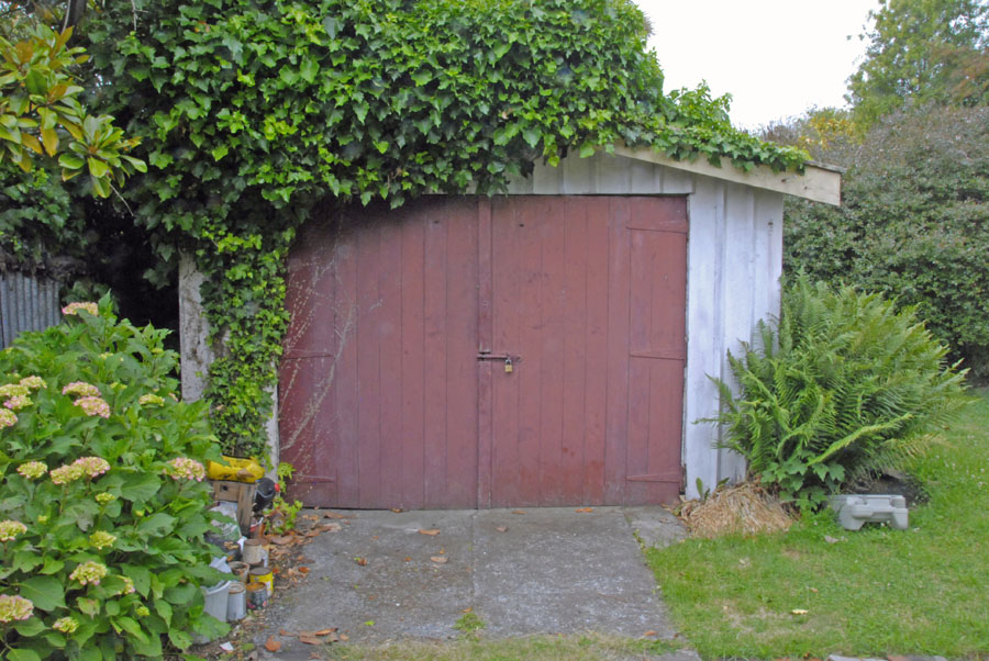

Recently I was told of a Dolomite Sprint sitting in a suburban shed that needs to be moved because the owners of the property want to sell. So in tracking down the owners I found a 1975 Sprint sitting in this shed in the bottom of a garden in the suburbs of Christchurch.
20151219-5592Pw HJ 1700 Shed Chch.jpg (203.31 KiB) Viewed 2202 times
