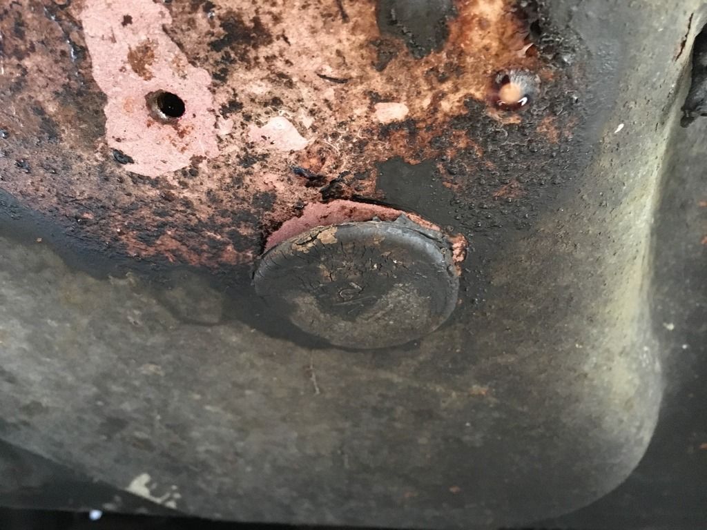

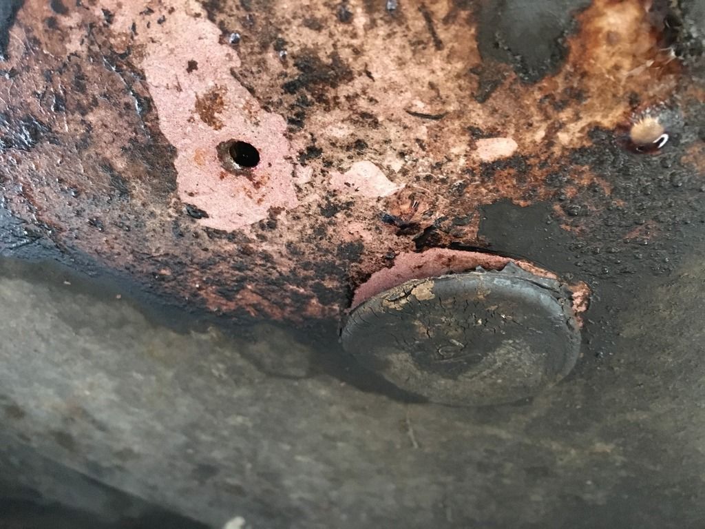

Just to help a bit I have taken a few shots of the underside of the tank to show you folks what I can see...
It seems that petrol is leeching out from around the dodgy looking rubber bung and also slowly dripping from that small hole... Should that hole be there...?!?!?!?!
I think the tank looks fairly solid on the whole to be honest...
Many thanks :wink:

If it is a drain hole? must be an old grommet which is not unleaded capable.
I wonder if a new grommet in both holes would do the job. (with some petrol resistant sealer)

That looks like the underside of the boot floor? not the actual tank??
You need to take the tank out and inspect it carefully. My tolly tank looked reasonable until I ran a wire brush over it. The loads of pinholes.
I was lucky and somebody on here supplied me with a NOS tank at very reasonable money. Was in 2009 though......
There are specialist who can repair tanks. I have had little success with epoxy patches etc in the past.

Blimey, I thought that was the underside of the tank! What a plonker...
Is the tank easy to extract?
I have a feeling I'm not going to like this discovery...!!!
Drats :roll:

A dolomite one is held in by 4 bolts and 3 bits of plumbing. The Toly one is pretty similar.
Egg on face for those who thought a tank would have a rubber bung....:-) Lol.

I did wonder about a hole and a rubber bung!
Oh well, everyday is a school day...
I can't believe my luck :lol:

Spot on Jonners my bad, brains still blanking out with my petrol tank woes.
