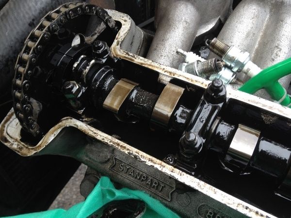

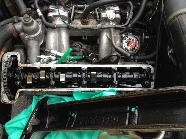

Unfortunately I haven't got very far today. I've had everything to bits but just can't figure out whats happening! One of the new neighbours came out of his house this morning, turns out he's an ex-banger car racer, but still no luck. We are definitely getting a spark, wondering if we have flooded the engine so I have taken all the plugs out and left it to air out for a few hours. Here are some pictures of the situation at TDC, everything looks right to me? We've tried the leads in all positions including 180. Its not even trying to fire though. And yes, I changed to the lucas 44D4 dizzy as you can see!

Here is how the leads are fitted on a Sprint from the factory (looking end on on the dizzy cap):-
On your photo there is a tab on the dizzy body between the 12 O' clock and 1 O' clock position. This is roughly the position the rotor arm should be pointing with the leads in this configuration.
That no.1 cam lobe (nearest the sprocket) should be pointing in the other direction, similar to no.2 in the photo.

Mart's been looking at too many Sprints...
Thats right for tdc no1 firing on an 8v. Put it back to 11BTDC
So now you want the points just opening and the rotor pointing at no1 plug lead. Then other leads go on in turn
to 3, 4 and finally 2.
Check the ballast bypass to the coil. Dolomites rarely start without this working.
