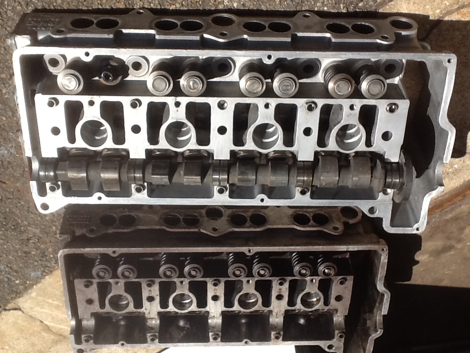

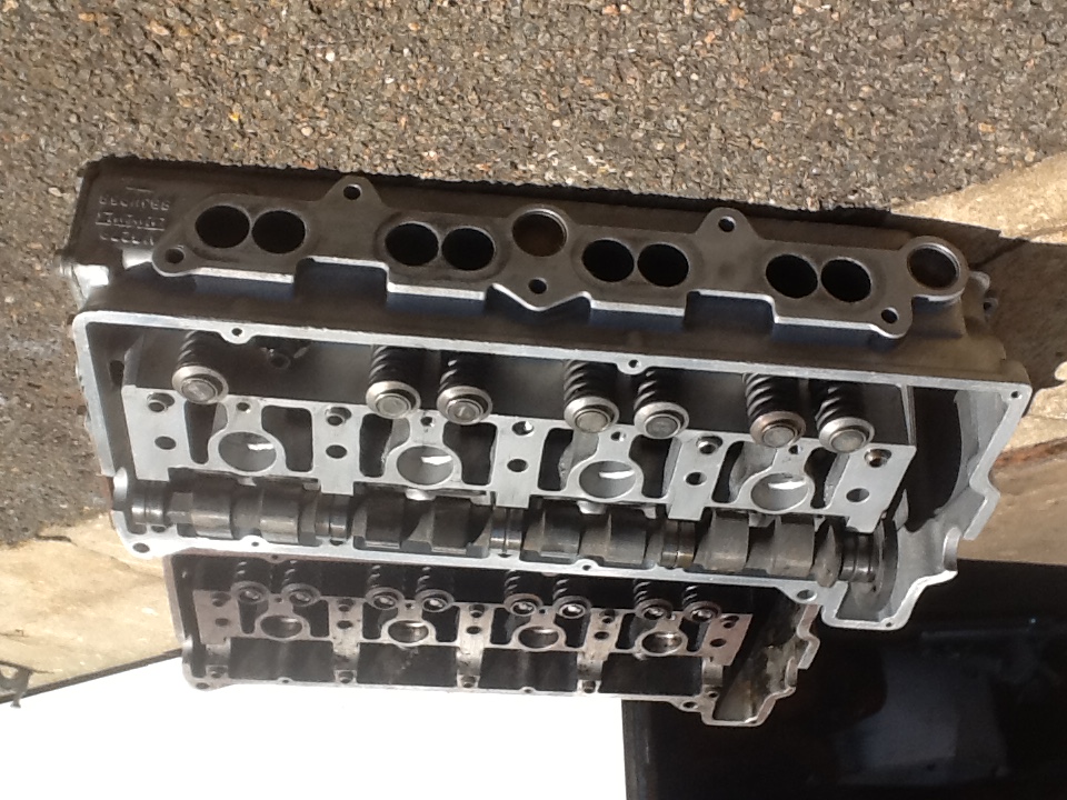

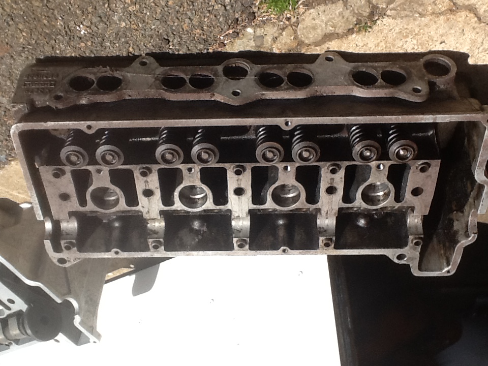

I have put both heads side by side
The only difference visually is the extra casting above the exhaust ports on the later ( number 2 casting number )
Simon
