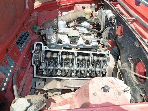

As you probably know, given the location and the angle Its tricky to see some of the detail. Ive ordered a set of LED mirrors to hopefully get a better view of things.

I think what has happened is the previous owner has drilled but then not fully tapped down the hole before inserting the helicoil. Whats then happened is that they have wound the helicoil in and at the lower point, with no threads lower down the hole (or the thread being shallower) its tapered the helicoil inwards (so image a cone type of thing).
When I screw the caphead in it 'bottoms out' or locks before all the others.
I may turn this the other way round..If I fit a set of 5/16 UNC studs in the holes, then use a set of domed 5/16 UNC nuts to bolt it down it will remove this problem.
Only consideration is that can you still get the cover on and off with 1" or so of stud sticking up?
