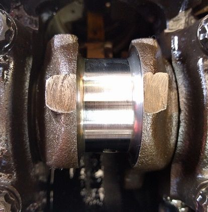

Mains (#2)
Crank (#2)
Big End (#2)

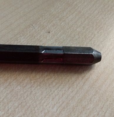

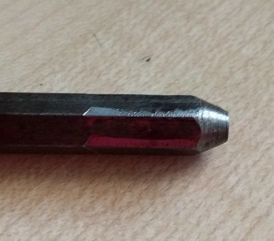

The issue I have picked up on today is the wear and the rounding off of the oil pump spindle:
Good end
Rounded end
Without a big leap of imagination, it wouldnt be extreme to assume that under certain conditions and a few more K's under the engine, that this rounding could become so bad as to no longer drive the oil pump or shear at high stress (or high RPM).
What are peoples opinions and has anyone come across this before?
