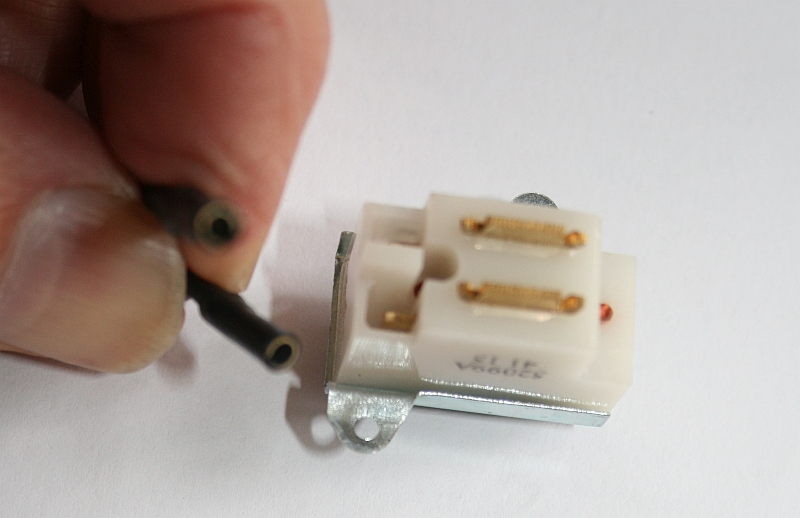

Excuse my ignorance, but I am new to Dolomites. I have bought a new O/D switch and wiring harness for the gear lever. I can't see how the wires are meant to be attached to the switch. In the blurry photo you might see what I have got. The wires end with small hollow round connectors, whereas the switch has no corresponding terminals onto which you could plug these connectors. How is it normally done please?
- OD Switch.JPG (239.35 KiB) Viewed 2375 times

They get inserted vertically on the nearest connectors to your hand. Slide the slots of the terminals on the wires over the copper terminals in the switch.

Ah, I think I see. Having inspected the hollow ends of the connectors with a magnifying glass I now see that the connector is slotted so it can slide along the blade in the switch. The plastic sleeve over the connector gets rucked up doing this and tends to force the connector off the blade, so I suppose I could slit the plastic for a centimetre or so. Weird arrangement if you ask me!
Since the O/D solenoid draws around 2 amps, I think a relay in the circuit would help preserve the switch, which is marked Lucas but I'm guessing was made a long way from these shores.
