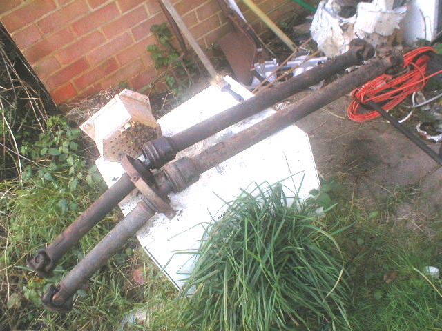

Anyone has a pic of the centre bearing and its location? Apologies for this question but still trying to find my way around the car -my experience is more on the Series Land Rovers and spitfires and never heard of a 'centre bearing' in the prop.

This piccy is of 2 Sprint props; The centre bearing is the bit suppoted by the cardboard box. The gearbox end of the prop; is on the left.ham204 wrote:Anyone has a pic of the centre bearing and its location? Apologies for this question but still trying to find my way around the car -my experience is more on the Series Land Rovers and spitfires and never heard of a 'centre bearing' in the prop.Carledo wrote:A clonk on taking up the drive could also be backlash in the axle. You really need to get underneath for a proper inspection. If the UJs are worn, especially the rear one, you'll have a nasty driveline vibration.
- Sprint prop 1.jpg (129.2 KiB) Viewed 2307 times
Re: Replacement of UJ's
looking at the picture above, I suppose it's best to just remove the prop with centre piece complete and work comfortably on a bench
