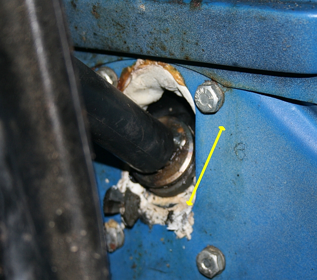

I'm not familiar with how the bottom end of the steering column is constructed on my 1850HL. I have found that there is quite a lot of movement up and down in the plane shown by the arrow in my picture. It must be 1/4 to 1/2 inch play. I can demonstrate the movement by lifting the steering wheel, or from under the bonnet by lifting the UJ. Can someone please explain to me how the lower end of the column is held in the bulkhead. I see there is a fitting held by four bolts. I guess it's to do with that but Haynes doesn't mention it, and the parts manual isn't clear either.

Re: Up - Down Movement at base of steering column
Either the bush or the hole in the plate for the bush could be worn. If you fit a SuperFlex bush you won't ever need to change it again. Is the bush fitted correctly? If it isn't all the way in the plate then you'll have the movement you've described. Something else to check is if the plate is moving.
The hole within the bulk head plate is probably oval thus giving horizontal movement. The only way to check this is undo the knuckle joint, remove the steering column, pop that bulkhead plate off, remove the bush and check the hole.
It shouldn't be too difficult to do. The steering column is an adjustable one so the bottom part should just slide out once the top pinch bolt has been removed from the coupling and the adjuster has been loosened. Once the column is out of the way it should be easy enough to take the bush out to check if the hole has indeed ovalled.
Those two dark colour blobs by the lower left bolt holding the bulkhead plate look awfully like bits of the bush to me.
You may be right. The car has been in storage for 25 years so anything is possible! I have a whole host of jobs to do to get her roadworthy again.Those two dark colour blobs by the lower left bolt holding the bulkhead plate look awfully like bits of the bush to me.
So it could be the orginal bush then........fitted the correct factory way from the inside out....Bumpa wrote:You may be right. The car has been in storage for 25 years so anything is possible! I have a whole host of jobs to do to get her roadworthy again.Those two dark colour blobs by the lower left bolt holding the bulkhead plate look awfully like bits of the bush to me.
I thought the steering bush was normally fitted from the inside out ie pushed through from the inside.
I have a superflex one; that's how I did it
And Bumpa your's looks a lot like mine did - I'd agree those look like bits of the old bushing

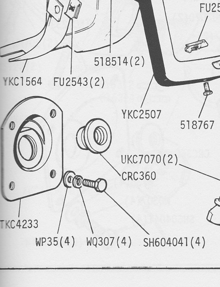

The parts diagram makes it look as though the bush is inserted from inside the car.
- Dolly Bush_20170307_0001.jpg (160.51 KiB) Viewed 1659 times
- Flyfisherman
- Posts: 980
Correct - less chance of pushing the bush out when refitting the steering column, even BL got this one thing right.Bumpa wrote:The parts diagram makes it look as though the bush is inserted from inside the car.
I would characterise one side of this steering bush as flatter and wider (as FlyFman says "less chance of pushing the bush out when refitting the steering column") and the other side as pointier and deeper - lending itself to pushing through the hole in the bulkhead.
So the only thing I would say about this is that once pushed through the bush presents visibly inside the engine compartment and the net result is that the upper UJ shaft assy ends up snug against the face of the steering bush - leading to consequent squeaky noises when turning the steering
You need a new bush. My thoughts on which way round it goes are well known....
