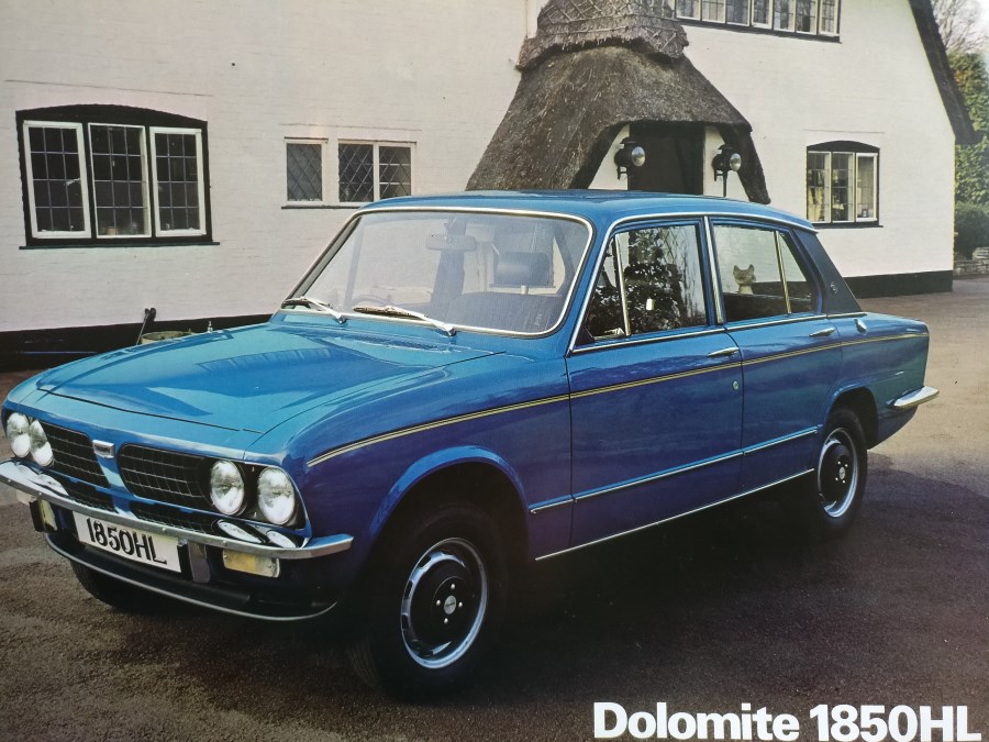

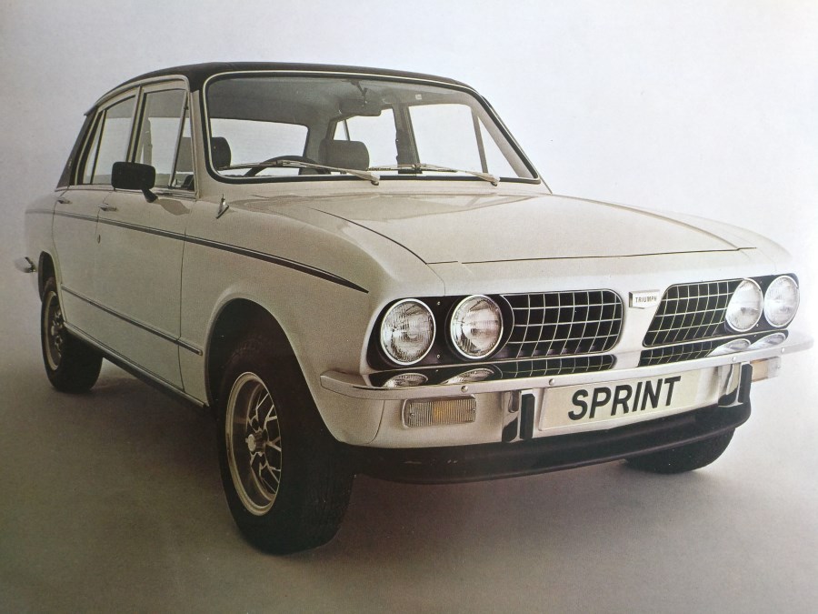

Galileo
Posts: 1297
Re: What colour should the sills be?
#10 Post by Galileo »
From the brochure dated 12/78
Posts: 7249
#11 Post by Carledo »
That would still be about right for the Sprint at least, I'm not so well up on 1850 comm number series.
My Sprint, VA 26140, is one of the last of the series 3 cars, the last, IIRC being 268XX. My car was registered 1/8/78, the first day of the T reg.
Series 4 cars, VA 30000> began either very late in 78 or early 79 and it is at this point I think the sill moulding was deleted. I don't think this minor change was the cause of the new series starting, there were other detail changes at this time as well, like the introduction of dual circuit brakes, nor do I think it had anything to do with the rust propagating qualities of the clip holes. It was probably just a cost cutting exercise by the bean counters!
It is highly likely therefore that a brochure issued in Dec 78 and probably prepared a month or so earlier would show a series 3 Sprint and a similar equivalent series 1850HL.
Ironically the 1850HL shown here has it's pinstripes like Bumpa's car in another thread, not like the ones on my earlier 77 model! Another detail change for the rivet counters?
