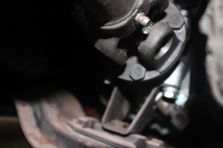

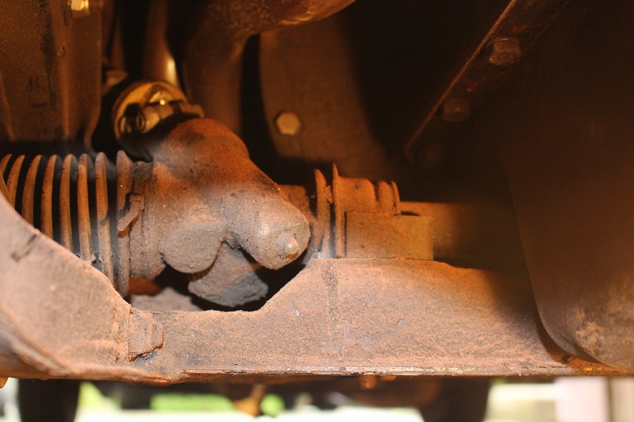

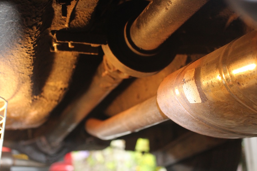

I've got an inspection pit in my garage so I went down this afternoon and took some pictures
Alan:
Alan:
- IMG_1152rsze.jpg (219.2 KiB) Viewed 2227 times
- IMG_1151rsze.jpg (109.08 KiB) Viewed 2227 times
- IMG_1149rsze.jpg (144.83 KiB) Viewed 2227 times
- IMG_1150rsze.jpg (141.15 KiB) Viewed 2227 times
- UJs do seem to be at different angles
- IMG_1148rsze.jpg (122.97 KiB) Viewed 2227 times
- IMG_1147 rsze.jpg (172.72 KiB) Viewed 2227 times
- Engine seems clear of steering rack
- IMG_1146 rsze.jpg (167.62 KiB) Viewed 2227 times

Only looking at the pics, could be the angle,
is the prop low on the centre bearing, the rubber looks compressed lower down.

Re: Can't solve my 1500HL problem
Your propshaft is out of phase if I am understanding the pictures correctly. I am assuming that your second and fourth pics are of the front UJ, and the fifth pic is of the rear UJ. Also that you did not roll the car backwards or forwards between taking these pics.
If all of that is correct, the front yoke of the front UJ is lying east/west (ish), but the front yoke of the rear UJ is lying north/south (ish). Does that make sense?
If so, and you confirm that is indeed the case, the propshaft needs to be separated at the central spline, and reinserted on a different spline which will align the front and rear yokes, which puts them back in phase.
Also try and maintain any balance marks on the UJ flanges, where they connect to the gearbox at the front, and the diff at the back.
All of this may not resolve your problem, but it will eliminate one issue.
Hope this helps!

Alan, did you see my post above after your pics? I think you were posting at the time so may have missed it.
Have you checked whether your propshaft is indeed out of phase? If you didn't move the car between the pics you are about 90 degrees out of phase, which I think would give the worst vibration. Certainly worth checking.
I thought the phase looked ok, bearing in mind clockwise view one side and anti the other ?
