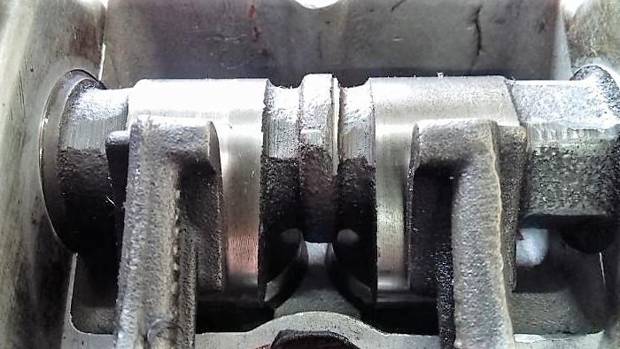

The engine I'm rebuilding was running Weber 48s and a modified cam. I haven't identified the cam yet but it looks aggressive compared to an STR91 (I meant to measure the cam lobes but forgot before I packed up for the evening). I did, however, measure the valve to head dimension when the inlet valves were at their fully open position, which was 8.5mm. I just wondered if somebody can measure a standard Sprint head in the same way for a comparison. The reason being is that there is evidence of the valves hitting the tops of the pistons at some point in time. The head is also fitted with double valve springs.
The cam is marked as 'Stanpart' and also 'STR 0516'. This is cast on the body of the cam not on the end. There is also an extra 'lump' between cylinder 4 lobes. I've not seen this before, anyone?

It is purported elsewhere that STR0516 refers to the cam blank, not any specific profile...

I measured the cam lobes this morning and there is a cam lift of 0.433" (measured with a vernier). This looks like the cam is an STR139 (or similar) which is what I suspected with the double valve springs. and the nicks on the piston crowns. Stripping the head there are four helicoils needed. The bottom valve spring retainers (148885) are different than standard, possibly custom made. None of the standard valve stem oil seals are fitted on the exhausts but some did have 'O' rings, I say some, I think about half of them, although I can't see what use they would be. I tried a standard seal but the inner spring wouldn't fit over it.
