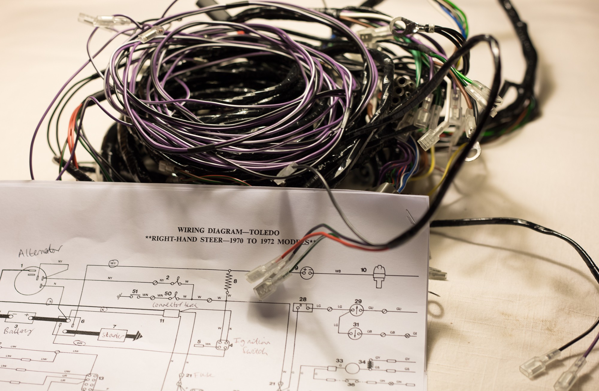

New wiring loom manufactured. This was a bit of a pain, but we got there in the end.

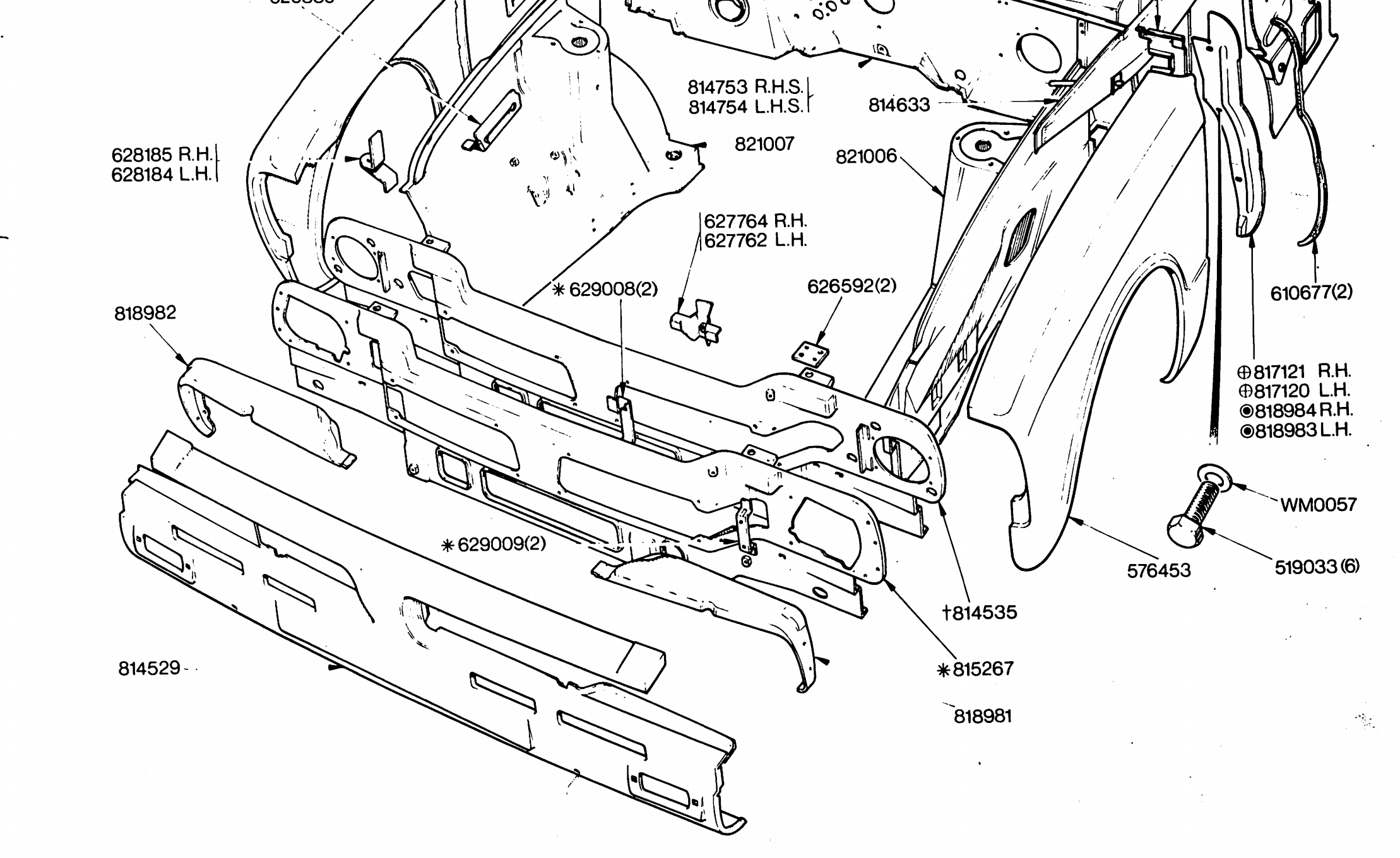

Here's the parts catalogues for comparison:
1971 Toledo
1973 Toledo
1976 Dolomite

Other than the badge holes on the nearside front panel top (which should really be drilled before the panel is painted unless you intend to stick the Triumph badge on), the lower panel has two holes used on the early Dolomite's for the under rider support bars. These are redundant on Toledo's, but are a noticeable feature on the front of them. These can be seen on your photos of your car with the original panel between the number plate and the sidelight / indicator units on each side. It should be noted that these are not simple holes but they are also flared inwards.
Very early cars also had a third type of front panel which lacked the lower lip for mounting the front spoiler used on Dolomite's. I am not 100% sure, but from your photos on this thread it looks like your original had the lip, but it is difficult to confirm this from the photos.

Thank you. I'm glad I posted here as I wouldn't have spotted the flared holes. I will discuss it with the body shop. I guess it shouldn't be *too* much work, although I can't find the original bits of the car so don't have the measurements.
I also found a bit of a discussion here:
"Version 1 used front panel 814529 and version 2 used XKC0504. Visually the earlier type has a shallower valance leaving more
of the front subframe/suspension visible. There are no holes for attaching a Sprint spoiler."
Only 814529 is mentioned in the 1971 parts book so my car probably has this. Probably not a lot I can do about the valance being shallower, ho hum...
Re badge holes it was my intention to cut the lugs off the Toledo nose badge and stick it on rather than drill, but I haven't made a final decision here yet.

With reference to the earlier valance being shallower, I don't think this is necessarily correct, as far as I am aware there is only a single part number for each Dolomite and Toledo front wing. I.e they did not change them requiring a new number, and as both early and late valances would need to meet the wings at the same point I do not see how one could be shallower than the other.
A number of years ago there was a seller at Stoneleigh that had half a later valance and the opposite half from a early valance, from memory I can only remember the earlier valance missing the mounting lip for the spoiler which is more or less horizontal to the ground, not that it had a different profile.
I was editing my earlier post when you replied to it, as I stated in my edit, from your photos, though I cannot be 100% it looks like your original had the mounting lip, so adding the holes should see the valance correct for your car. As to the holes I'm sure we can sort the dimensions out for their locations.
