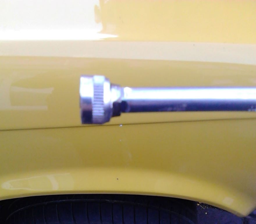

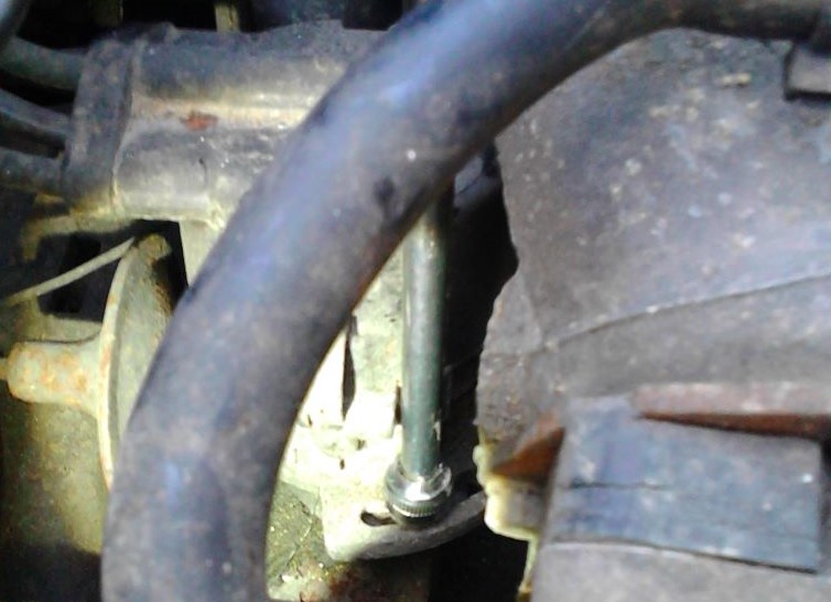

I went and looked at the job on the Doly and realized what I didn't say was I having trouble doing it on the TR7 Sprint. I now realize there's enough room to get the the back bolt in the Doly because the transmission tunnel allows access. The TR's tunnel is tighter and the bulkhead is close again the back of the engine, and the back bolt's a bugger to get to. I've nearly never done the job on the Dolomite, and never bothered to look if it was easier, till I lost my old socket that fit.
But, I've possible solved the problem with a grinder.
Don't worry, it was only a Silverline, and I've at least 3 other 7/16ths 1/4 drive ones.
I still may need a flexible drive shaft or knuckle if the TR's dizzy is turned more than the Doly's, but at least the socket fits on the set screw head.
Graham
