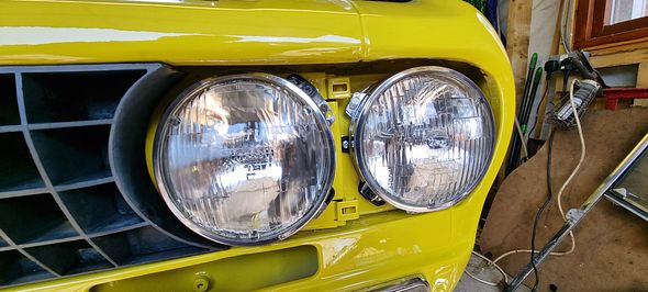

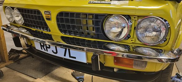

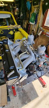

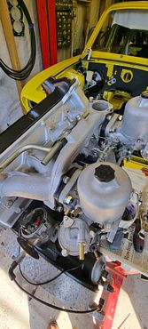

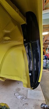

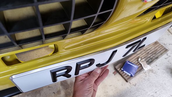

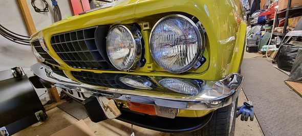

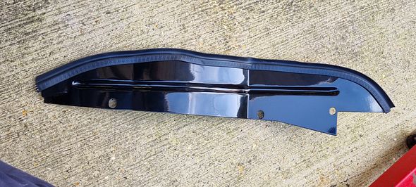

Really not done much over the past year on the car. I am pretty determined to get it finished this year!
One thing I am struggling with is finding someone to glue up the new Headlining & fit the vinyl roof, if anyone knows someone in Hampshire please let me know.
Anyway here's a few photos for you:
Period numberplate, needs a gentle bend added to fit the front panel, I used spacers & double side adhesive to fit it.
Headlights fitted up, with 75W inner sealed beams
Bought a lovely set of early carbs & manifold off ebay
Front Bumper Fitted
NOS inner front wing baffles powder coated, new seals & fitted.
Will try to update this a bit more regularly. :thumbsup:
