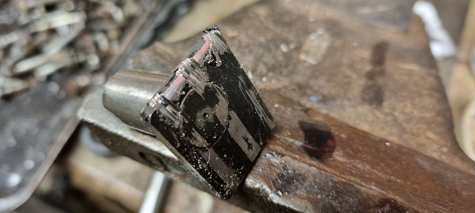

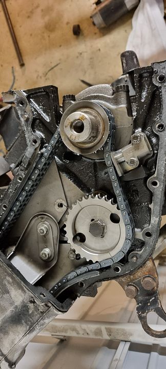

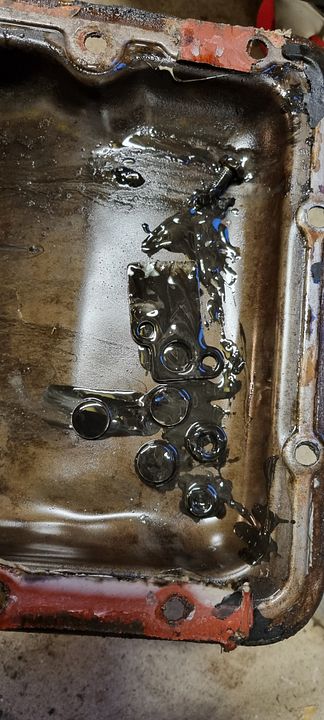

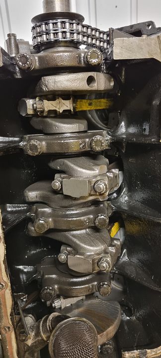

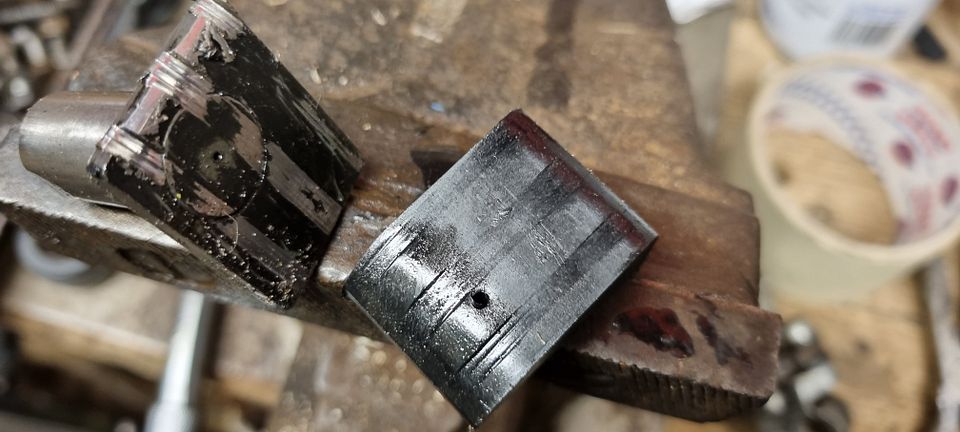

Thought I'd take a look at the engine today, I bought it as a good running engine but never heard it actually run. The owner said it had had some work done to it recently but didn't know much about it. I thought I would whip the sump off & also check the timing chain tensioner before fitting it into the car, glad I did:
Rolon tensioner with the slipper pad dislodged
Sump had 3 shims, a couple of washers, cam bolt & the tensioner plate in the bottom

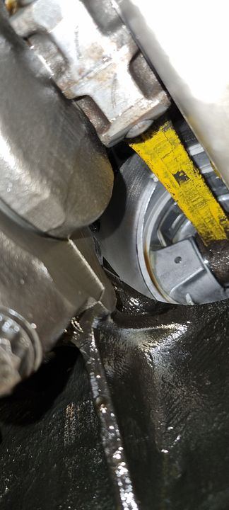

Otherwise it all seems quite clean, the conrods have yellow paint on them, any ideas why?

A reminder to beware of Rolon tensioners there and the fact some suppliers now supply Rolon as a supersession to OE parts including the Jaguar EAC3629. SNG Barrett supply both the Jag OE at £90.50 and Rolon 'equivalent' at £16.50!
A reminder that alternative and more economic solutions to the Jag part are now available: https://forum.triumphdolomite.co.uk/vie ... 5&start=45

Fitted a very good used Renold Tensioner today.
I also fitted a new chain that I ordered from Robsport yesterday! It is Rolon brand so I hope it will be OK, I have not heard of any problems with these chains.
I opted for a new chain as the old one, although I could not see any damage, had made quite a gouge in the metal slipper support.
The slipper pad on the Rolon Tensioner had hardly any wear on it, so must have failed very soon after fitting.
Another reason to replace the chain was I noticed a damaged tooth on the crankshaft timing gear, so replaced this aswell.
