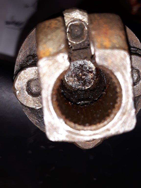

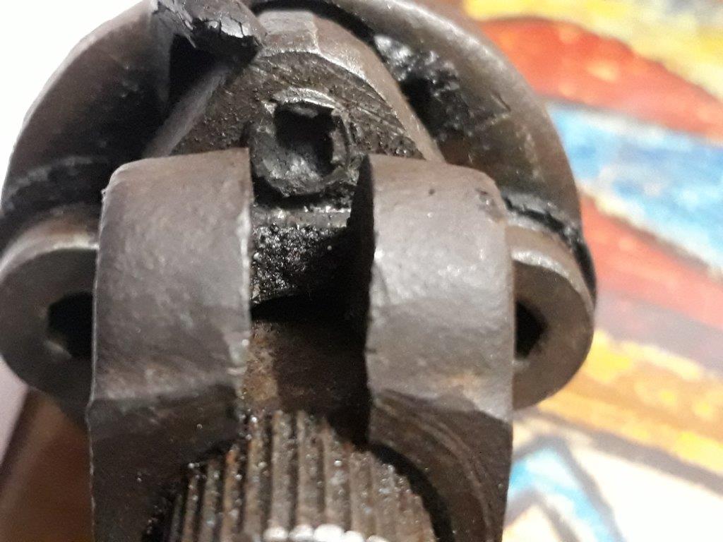

Re: Steering Shaft/Knuckle - Lower - FAM1718
Using this previous thread.............., I wanted to ask the question as to whether it is possible to remove these "crimped" bolts in my lower steering knuckle at all (see pics)? I am assuming that these are the crimped type as there is no wire at the end of the bolts, and the bolts also look slightly pressed to prevent easy removal..
So is there a method of getting them out at all, and also re-using the bolts? And if not, are there suitable bolts that can be used in the rebuild?
I would prefer to use the knuckle that I have and re-bush it etc, but not entirely sure that this is actually achievable.... hence the post.
Any views or words of wisdom please on this??
Thanks in advance...
