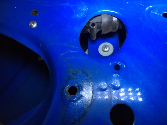

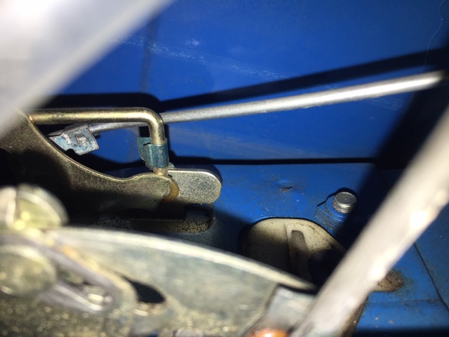

Fitment to right rear door
I had to remove the door catch mechanism to fit the linkage direct to that, then mount the solenoid down near the lower rear edge As per these photos - best I've got. Geoff (both sideways, first the right side is the top of the photo and left side of the second)
