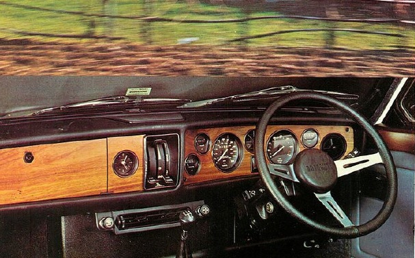

At last, I found a reference for the dash and door cap colours for a 74 y.m.
Graham

Any idea what the actual type of wood is that was used for the veneer? I need to redo mine at some point as the veneer is too far gone in places to just re-varnish/polish.GrahamFountain wrote: ↑Tue Jul 14, 2020 5:39 pm At last, I found a reference for the dash and door cap colours for a 74 y.m.
Graham
Roger

Someone will no doubt correct me if i'm wrong, but I seem to recall "American Walnut" being mentioned as the alleged wood for the veneer from the factory.marshman wrote: ↑Tue Jul 14, 2020 8:57 pmAny idea what the actual type of wood is that was used for the veneer? I need to redo mine at some point as the veneer is too far gone in places to just re-varnish/polish.GrahamFountain wrote: ↑Tue Jul 14, 2020 5:39 pm At last, I found a reference for the dash and door cap colours for a 74 y.m.
Graham
Roger
A photo, especially an old PR photo, is hardly a good guide to colour, so many things affect what you actually SEE and it could have been enhanced, tinted or downright airbrushed before it was even published!

Yes, but it is at least a reference against which those with more perfect memories can offer positive opinion as to if it's a bit dark or a bit pale, etc.Carledo wrote: ↑Tue Jul 14, 2020 9:39 pmA photo, especially an old PR photo, is hardly a good guide to colour, so many things affect what you actually SEE and it could have been enhanced, tinted or downright airbrushed before it was even published!marshman wrote: ↑Tue Jul 14, 2020 8:57 pmAny idea what the actual type of wood is that was used for the veneer? I need to redo mine at some point as the veneer is too far gone in places to just re-varnish/polish.GrahamFountain wrote: ↑Tue Jul 14, 2020 5:39 pm At last, I found a reference for the dash and door cap colours for a 74 y.m.
Graham
Roger
Graham

I expected the most obvious negative comment to be it's of an 1850, not a Sprint.
