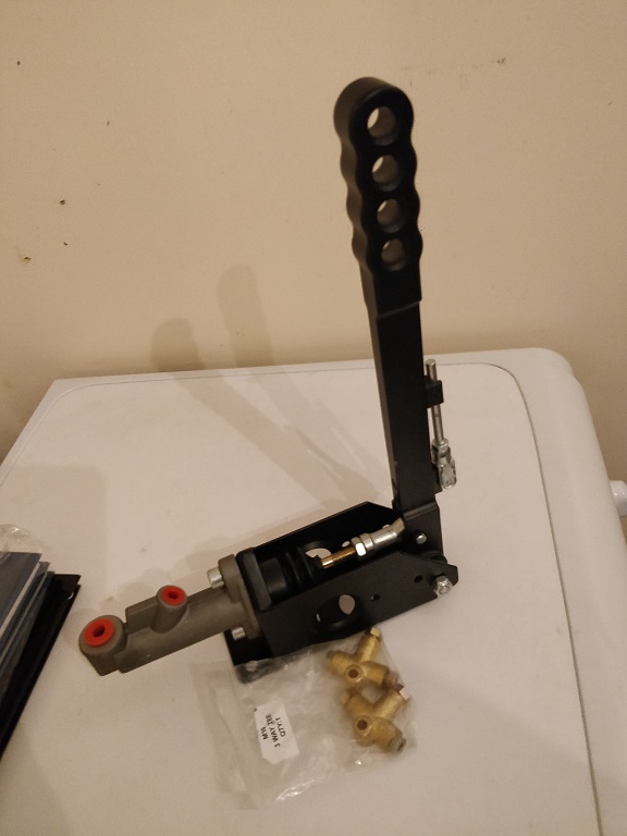

Hi Steve
As below I am running MG TF 8 spoke wheels with 185/55/R15 tyres.
Up front I already have TJ brakes with ford Puma calipers (54mm) and 239mm discs. As to a bais valve, I plan re-routing the line to the rear brakes into the car, to the hydraulic hand brake with a brake bias valve in series to allow adjustment.
Regards
Barry

File comment: hydraulic hand brake

Hi
As stated, I know they are functionally pointless :lol: , but thanks to Covid I have more time (no more commuting) and Money (all holidays refunded!) than I know what to do with, so I need projects.
To me, the joy of owning Johnny P (that's my triumphs name) / classic car is having fun and learning new skills. I really enjoyed making them up, fitting them, designing the brackets and writing it up on the forum.
Also, most importantly they look awesome :eyes4u: and cant wait to paint the front TJ brakes to suit, and start skidding about with my hydraulic handbrake! :mrgreen:
Regards
