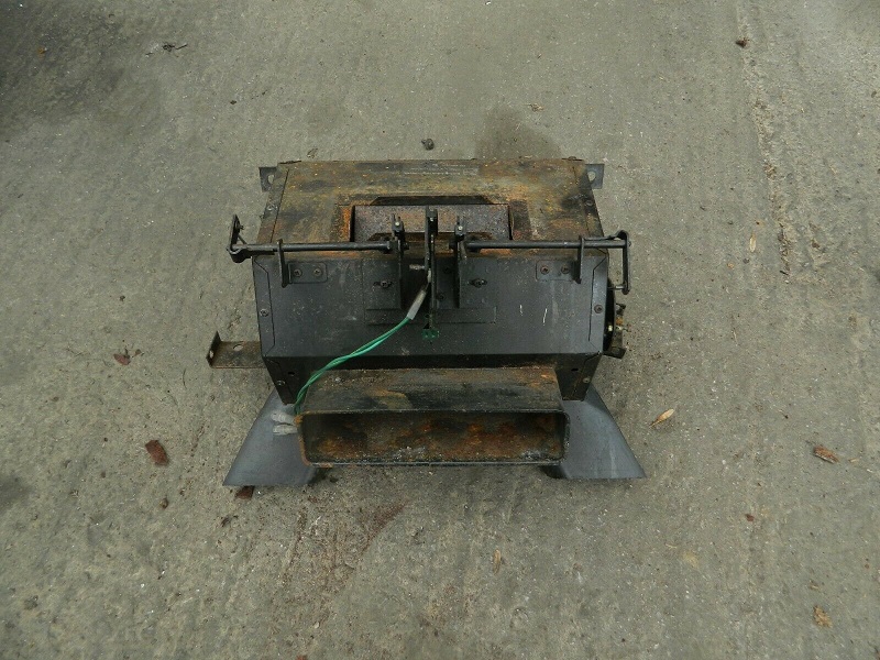

found a picture of a heater matrix that has a bracket still attatched
hope this helps

Thanks for the pic,
I seem to have a bracket (as shown in picture of mine) but mine doesn't have the left hand upright bend, and doesn't have the right hand bracket at all, but then neither does the the other pic.
Confused...!

sm519193 wrote: Mon Mar 22, 2021 8:15 am Thanks for the pic,
Confused...!
I got the picture from the web,
mine had the brackets with the upturned ends both left and right of the heater,
looking at your picture it looks like your brackets have been replaced by a non standard part.
