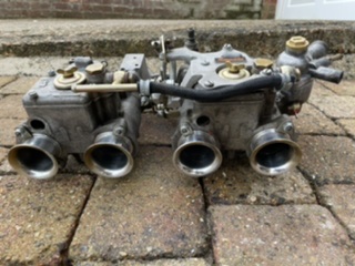

I will also have the carbs off, have the weber manifold blasted so it looks like new and fit a brand new pair of 40's.

Carbs and manifold off today for a complete strip down, rebuild and blasting.

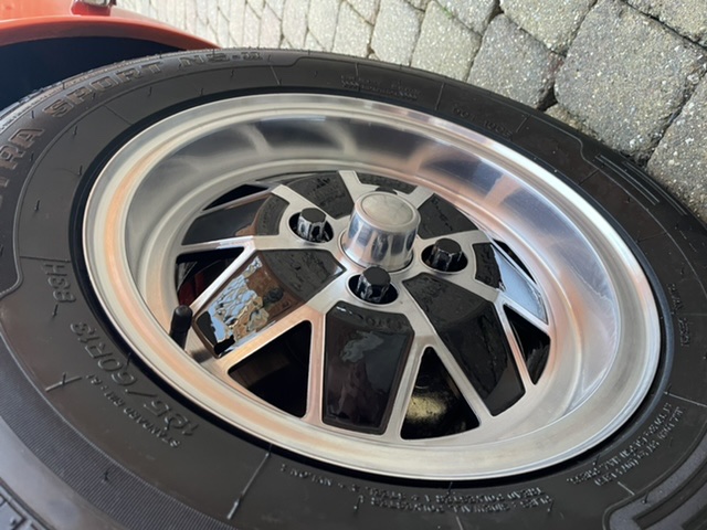

Just about finished my Winter / Spring jobs for this year. Happy with the results. This years jobs included the following. Few pictures attached.
1. Did the 123 dizzy conversion. That’s a game changer and completely changes the car. For a start it now starts again when you fill it up at Tesco.
2. Had the carbs and inlet manifold off. The twin 40’s were rebuilt. Car now a lot smoother.

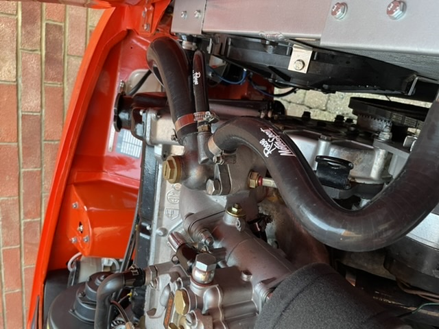

3. Changed all the hoses for Rouse Motorsport silicone hoses.
4. All the wheels were completely refurbed.

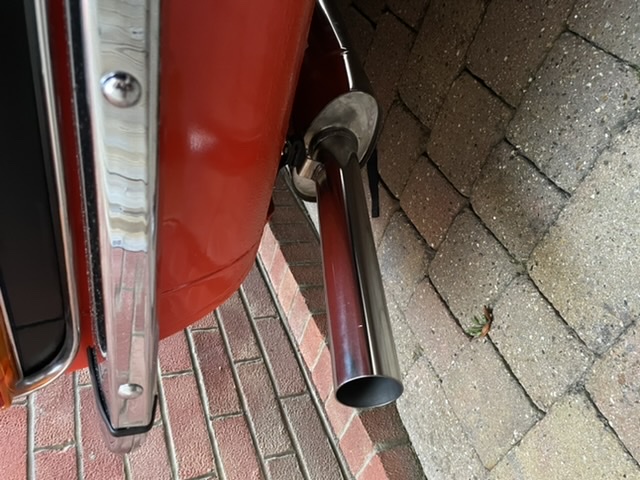

8. Swapped out the exhaust for a new stainless system.

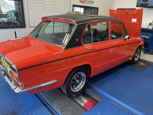

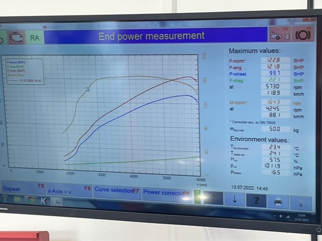

Took the car in for a rolling road run today. She got up to almost 123bhp, which although a couple of horses below name plate, I was very happy with.
The guy who ran the test explained the fueling was pretty spot on, tick over was smooth as was the power curve. He said you could always improve it, but I only use it on B roads and never intended her for track days.
Overall I was really happy. The car is really smooth, starts perfectly and idles bang on 1000rpm.
What more can you ask of a Sprint ??
