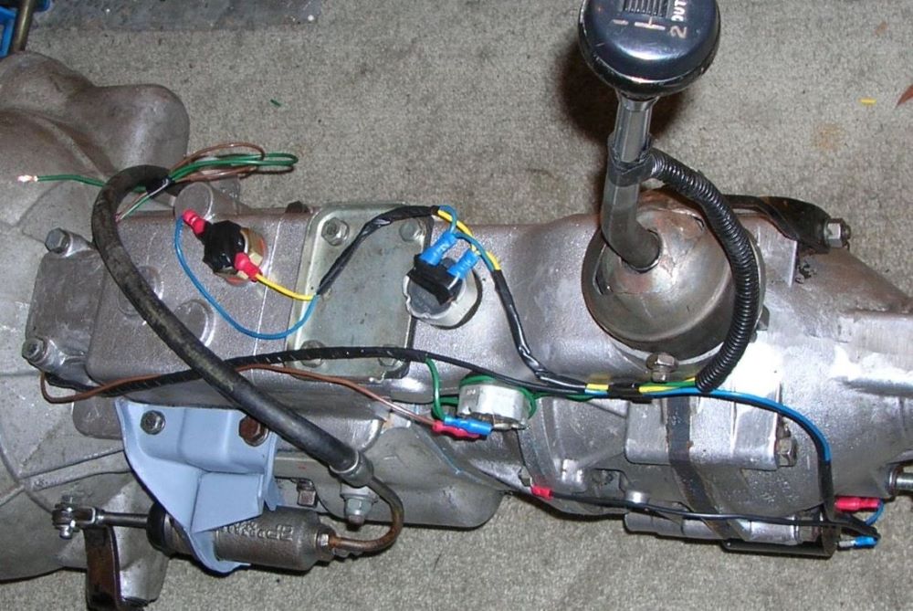

You definitely should have power to the solenoid when the gearlever switch is 'IN'. Try following back, using a test light or voltmeter to see how far the current reaches with the switch in. Hopefully you should then locate the fault. As long as the reversing light work, that will show if power is getting to that area as they both share the same green wire as the power source.
When I last rewired an overdrive gearbox, I used contrasting colours so thought the photo might be useful.
Green supplies the power to the reverse light switch and brown takes it back to the wiring harness and eventually the reversing lights.
Green also goes directly to the gear lever in/out switch. Once IN, power flows to the switch on the gearbox top (yellow wire) so when in the correct gear, power flows to the solenoid (blue wire). Solenoid is then double earthed (black). You should hear an audible click when it actuates. G'box in the photo has two switches, one operates on both 3rd and 4th, the other on 2nd. Just ignore the one on the left for your g'box.
Issues with non engagement are usually due to malfunctions with 1) the gearlever switch 2) the switch on top of the gearbox, or 3) the solenoid. Only way to really determine which is to remove the g'box tunnel and methodically work through finding out where power reaches. Remember that the switch on top of the gearbox itself needs the number of washers between it and the g'box casing to be adjusted so that it actually functions when g'box is hot and components have expanded.
Hope this helps
Hope this helps

- Posts: 7247
Re: O/D wiring issues
Note on the pic in the post above, this car has been improved by the addition of a second inhibit switch to permit the use of overdrive in 2nd gear as well as 3rd and top.
Just pointing it out to avoid confusion!
