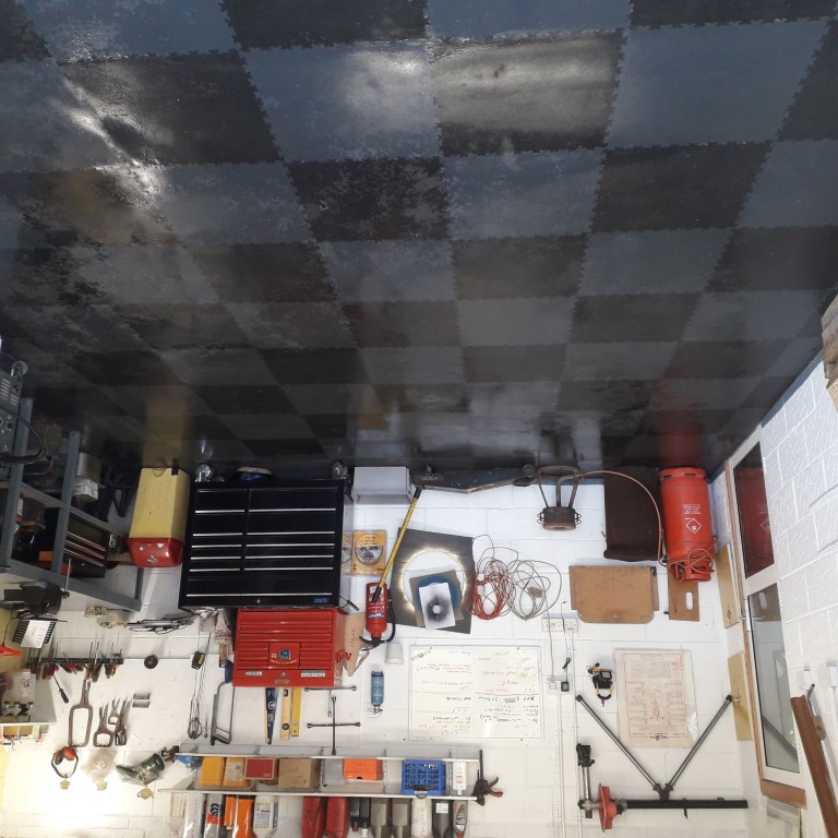

You should consider floor tiles. So much more comfortable to work on and insulating. I would not go back to paint.
https://www.garagefloortilecompany.com/
Jerry
Jerry
- new Floor (reduced).jpg (130.43 KiB) Viewed 16311 times

Just ordered a sample but it's going to cost me over £1200 for 45 square metres. What are they like for cleaning oil spills & the like?

Those tiles look superb.
The only thing that would concern me is if you do have a spill of oil (or a particularly leaky Triumph) is there a risk that the oil will then seep through the joints and just fester underneath the flooring?
Much nicer and warmer though to work with I am sure.

Yes that is my main concern, plus jacking up vehicles and moving heavy engine blocks around on an engine stand.Matt Cotton wrote: Those tiles look superb.

No problems with trolley jacks or engine cranes/stands. The tiles are really tough & join together tight enough to form a seal. Oil wipes off with a squirt of engine cleaner. Water will sit there overnight if you let it. The suppliers will send you samples to try. I put a couple of pieces under a trolley jack & left it supporting a heavy Jag overnight. The wheels left minor dents in the tiles which recovered after a day or two.
No connection to the supplier, just a satisfied customer. Worth every penny & if you heat your workshop the difference in temperature is noticeable.

Jerry, how did you cut your tiles & did you use any adhesive?

No adhesive required. Instructions say to cut with a stanley knife, which is impossible. Fine tooth toolbox saw worked fine. Large mallet and wood block for the joints. Any holes in the concrete deeper than say 6mm probably should be filled. My floor was particularly scabby so needed a bit of that self levelling compound in a couple of places.
One issue I omitted to mention: you need to leave an expansion gap round the edge, however direct heat on one area will cause the tile to expand and buckle slightly. This can happen with bright sunlight streaming through an open door. Also happens with my gas heater - just have to stand the heater on a wooden pad and move it around to avoid concentrated heat. None of this actually matters as the tiles regain their shape on cooling.
You'll never have to paint again.
