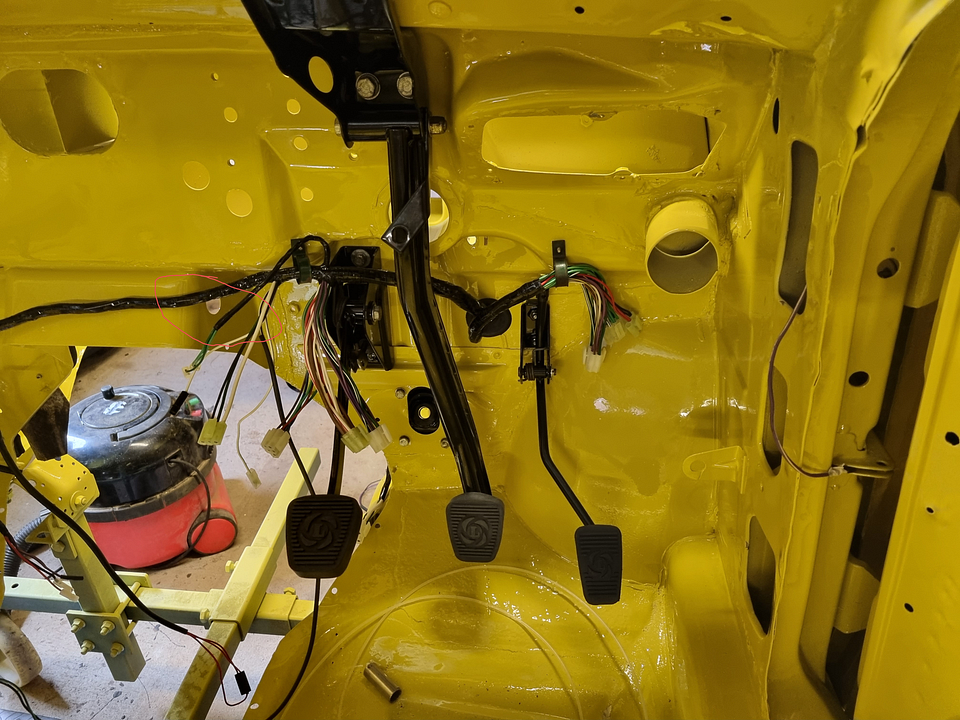

I think on early cars the Speedo cable takes a different route, it enters the car through a hole just above the gearbox tunnel, shown in this picture, whereas later cars it comes through the bulkhead, might explain the difference.
This is all from memory so I could be speaking rubbish!
