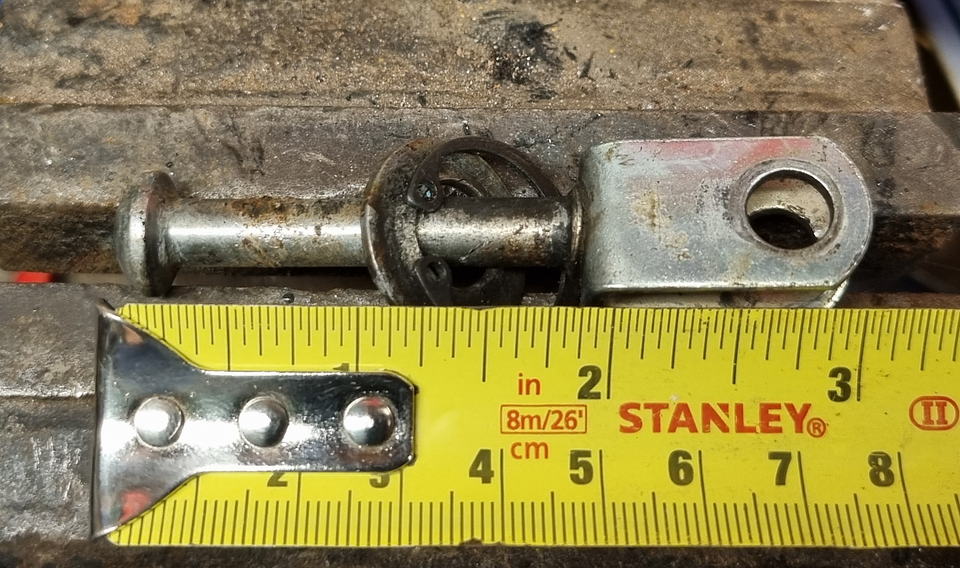

Hi Both,
My slave cylinder has gone and could no longer change gear while the engine was on.
The clutch pedal did sit quite high up so was just checking what the normal should be. As i have taken it all apart thought now is the time to see if the push rod is the correct length.
I have attached a picture of my current one
Let me know your thoughts.
Thanks,
Re: Dolomite Sprint Clutch Hydraulics
Posted: Thu Apr 18, 2024 8:59 pm
by xvivalve
Looks too long to me...

Just got MSO out of storage, clutch pedal went straight to the floor, master cylinder seals gone, so just replacing it.
Push rod is 3" long.
