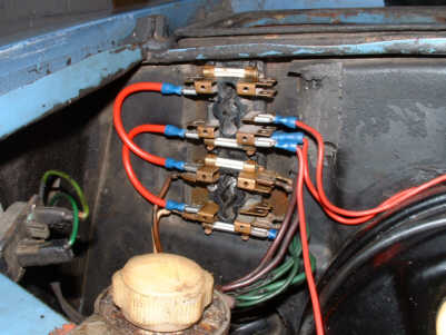

Last week whilst out in my track Sprint (Smifter driving <!--EZCODE EMOTICON START :lol --><img src=http://www.ezboard.com/intl/aenglish/im ... /laugh.gif ALT=":lol"><!--EZCODE EMOTICON END--> ) a fuse blew & car came to a complete stop. After careful investigation (and Smifter remembering having the same prob.) we decided there was just too much juice being drawn off the one fuse, what with leccy ign., fuel pump, fan etc. Anyway, I had a spare fuse box & managed to squeeze it in above the original & moved the VS to the inner wing.<br>
