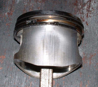

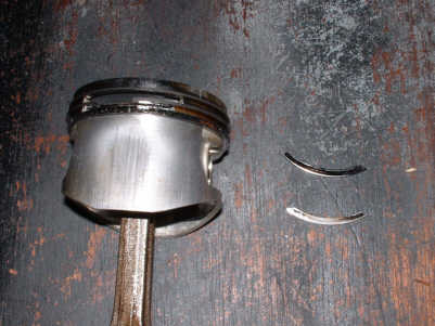

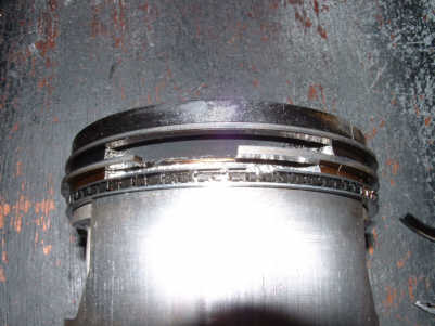

Pist & Broke
OK, it seems to be the season for broken pistons. Here's a few pics of mine:-<br>
<br>
<!--EZCODE IMAGE START--><img src="http://www.dolomitesprint.com/images/misc/mypiston1.jpg" style="border:0;"/><!--EZCODE IMAGE END--><br>
<br>
<!--EZCODE IMAGE START--><img src="http://www.dolomitesprint.com/images/misc/mypiston2.jpg" style="border:0;"/><!--EZCODE IMAGE END--><br>
<br>
<!--EZCODE IMAGE START--><img src="http://www.dolomitesprint.com/images/misc/mypiston3.jpg" style="border:0;"/><!--EZCODE IMAGE END--><br>
<br>
<br>
I measured the top of the piston dia. which is 90.75mm. approx.<br>
<br>
Anyone got a spare set of +0.040" pistons going cheap?<br>
<br>
Or do I take a chance on one of the two spare blocks I have?<br>

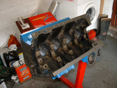

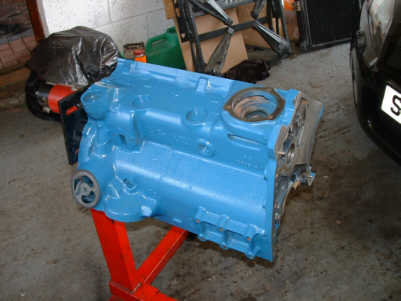

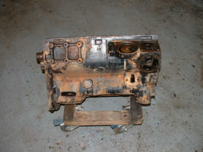

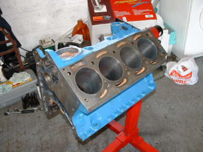

Re: Block
It was too hot today to start lifting engines out so I just dismantled a few bitz & gave Smifter's old block a refurbish. Every orifice cleaned out & ran a tap down every bolt hole.<br>
<br>
<!--EZCODE IMAGE START--><img src="http://www.dolomitesprint.com/images/misc/block.jpg" style="border:0;"/><!--EZCODE IMAGE END--><br>
<br>
<!--EZCODE IMAGE START--><img src="http://www.dolomitesprint.com/images/misc/block1.jpg" style="border:0;"/><!--EZCODE IMAGE END--><br>
<br>
<!--EZCODE IMAGE START--><img src="http://www.dolomitesprint.com/images/misc/block2.jpg" style="border:0;"/><!--EZCODE IMAGE END--><br>
<br>
<!--EZCODE IMAGE START--><img src="http://www.dolomitesprint.com/images/misc/block3.jpg" style="border:0;"/><!--EZCODE IMAGE END--><br>
<br>
<!--EZCODE IMAGE START--><img src="http://www.dolomitesprint.com/images/misc/block4.jpg" style="border:0;"/><!--EZCODE IMAGE END--><br>
<br>
<p>Martin<br>
