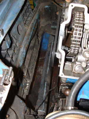

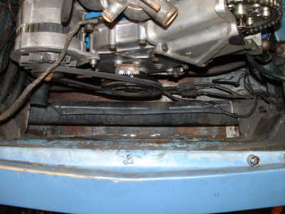

"Fits perfectly" is a slight misconception. It does need a bit of fettling. It's about the same width but about 100mm. higher than the Sprint's.<br>
<br>
<!--EZCODE IMAGE START--><img src="http://www.dolomitesprint.com/images/misc/volvorad2.jpg" style="border:0;"/><!--EZCODE IMAGE END--><br>
<br>
<!--EZCODE IMAGE START--><img src="http://www.dolomitesprint.com/images/misc/volvorad1.jpg" style="border:0;"/><!--EZCODE IMAGE END--><br>
<br>
I am in the middle of "doing the mod" so will have more pics soon (too hot the last couple of evenings). Scott has done it so he may put some pics up as well. <!--EZCODE EMOTICON START ;) --><img src=http://www.ezboard.com/images/emoticons/wink.gif ALT=";)"><!--EZCODE EMOTICON END--> <br>
<br>
As far as I can tell, the large top hose (left) should fit ok, but the small top hose is about 4" lower down the side of the Volvo rad & bottom hose will need some attention as that is also about 4" lower. I'll let you know how it goes. Watch the "Worn Ring" thread. <!--EZCODE EMOTICON START :D --><img src=http://www.ezboard.com/images/emoticons/happy.gif ALT=":D"><!--EZCODE EMOTICON END-->
