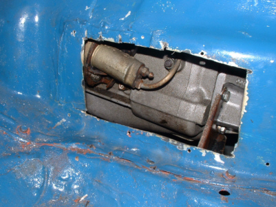

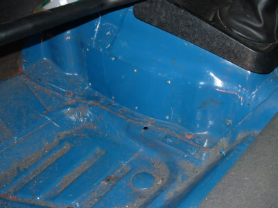

Re:Cluth Bleeding
I do my access holes like this:-<br>
<br>
<br>
<!--EZCODE IMAGE START--><img src="http://www.dolomitesprint.com/images/gbic1.jpg" style="border:0;"/><!--EZCODE IMAGE END--><br>
<br>
<!--EZCODE IMAGE START--><img src="http://www.dolomitesprint.com/images/gbic4.jpg" style="border:0;"/><!--EZCODE IMAGE END-->
