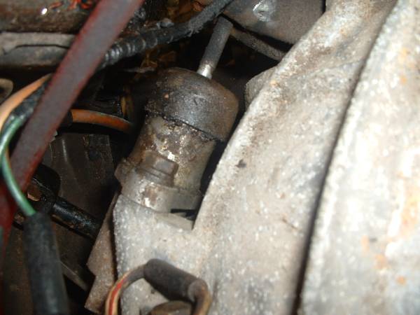

Ok so we went out and put back the slave, took some pictures and messured the distance between the arm and the slave. Top of slave to arm is ~45mm (about 1-3/4"). The push rod is just 3" or about 75mm but that includes the mushroom on top and the distance inside the slave. Thinking there is no more than 15mm - 20mm of movement at the very most.
The pics speaks by them self. Arm looks as you can see normal. Maybe someone can spot what is wrong -- or is this how it should be???
Cheers Dyna
Cheers Dyna

Wrong offset cylinder.

Re: 1850 Clutch problem
Super thanks Craig,
It's 100% the wrong slave we have. It's the wrong offset as Jeroen says. It's funny since we bought a whole setup from rear axle all the way to the flywheel and the slave was the one sitting on the box. Talked to hubby and his guess is that it will kind of work but barely (we never got the chance since the hose burst since it was pretty chafed) . Anyways ordered a new slave and hose. Think we need to buy a kit to make your own clutch and brake hoses with all the hoses we bought over time it will for sure be cheaper (Well unless you really need one of those 5000 pound crimping presses).
