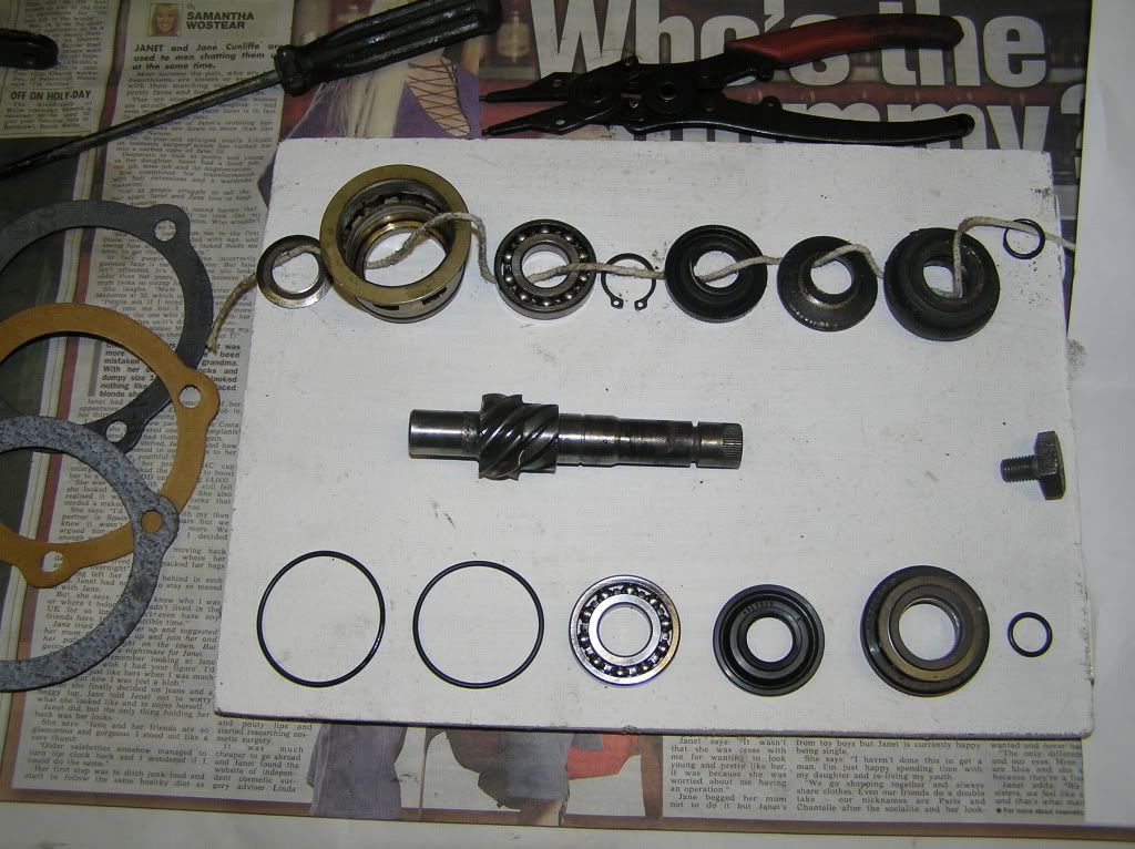

See current photos below for an assembled pump prior to recon, and a stripped pump (minus impeller) + repair kit .
I'll post the impeller pics when I get it back.
At the top of this pic is the disassembled waterpump.
I used string to help me remember the assembly order and orientation.
The bottom part of the board shows the repair kit from Tony Hart.
The only things different for my application is that I will source a new circlip and use the graphite seal which matches up to the ceramic 'polo' insert. I have a sneaky suspicion that the graphite seal will be identical to the one shown. I still need the ceramic part though :wink:

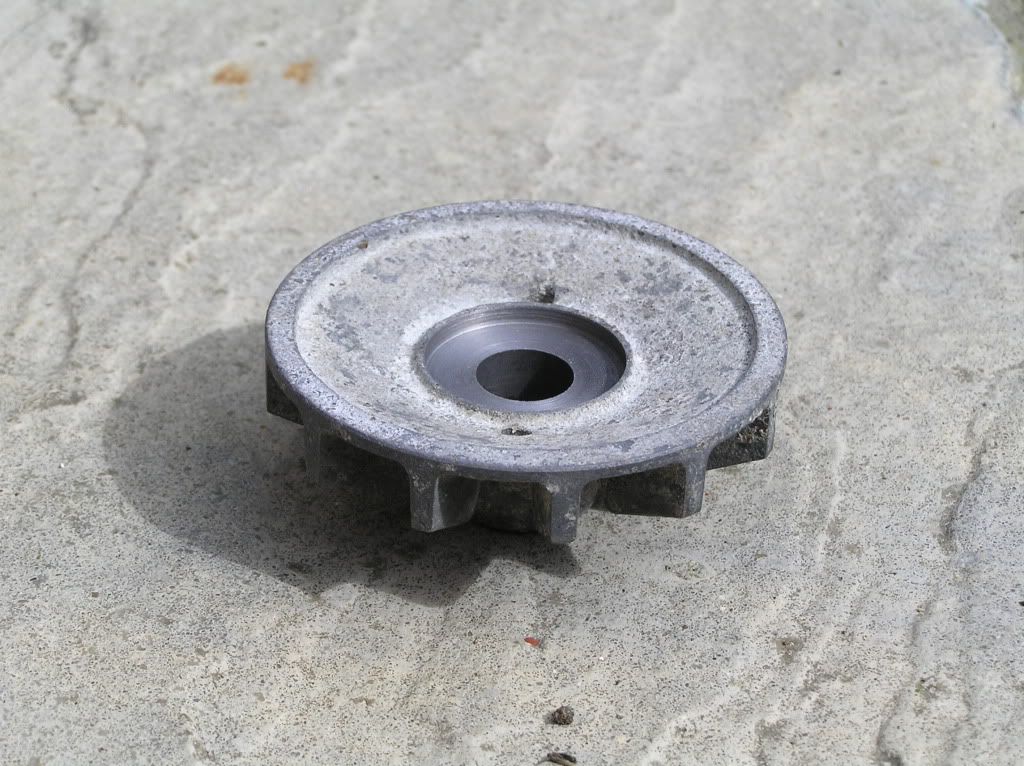

OK so waterpump machined for ceramic 'polo'

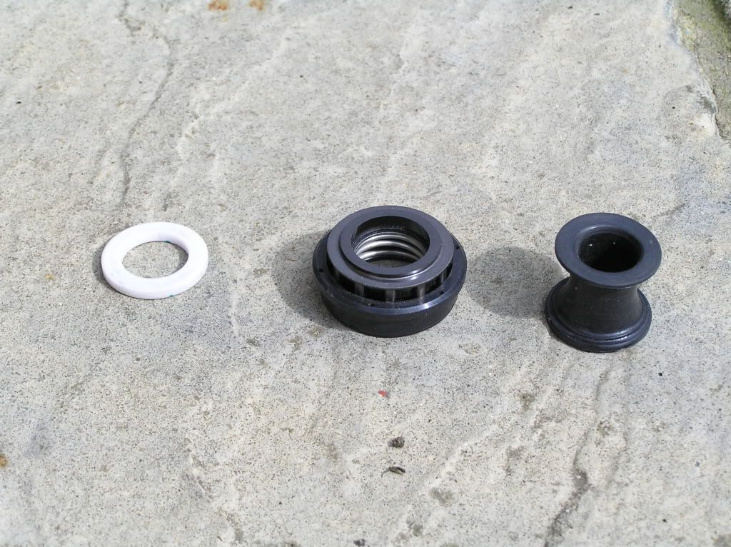

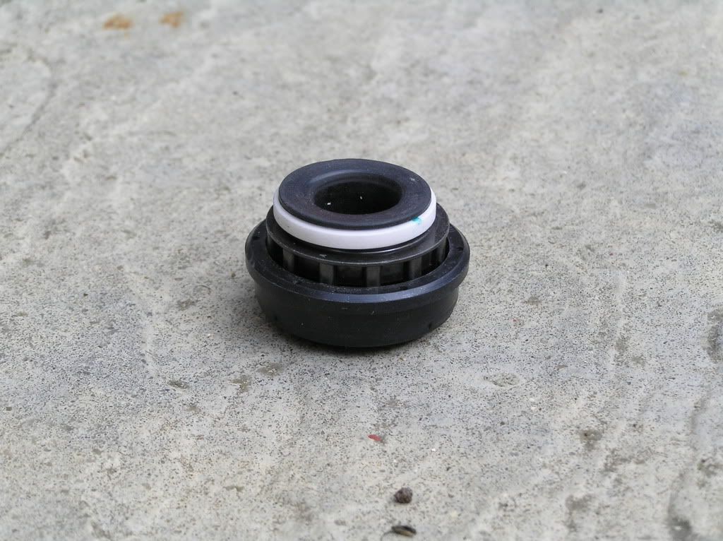

The full replacement top seal with rubber insert holding it in place (the insert is discarded at assembly)
The top seal and ceramic 'polo' separated from the rubber insert.

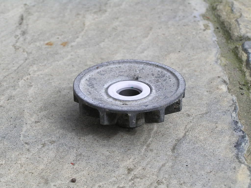

Polo in position, shiny side up (I eventually used Wickes external grade silicon to hold it in place permanently)
This method is supposed to be the best way to keep the coolant in.
Let's see what happens...
