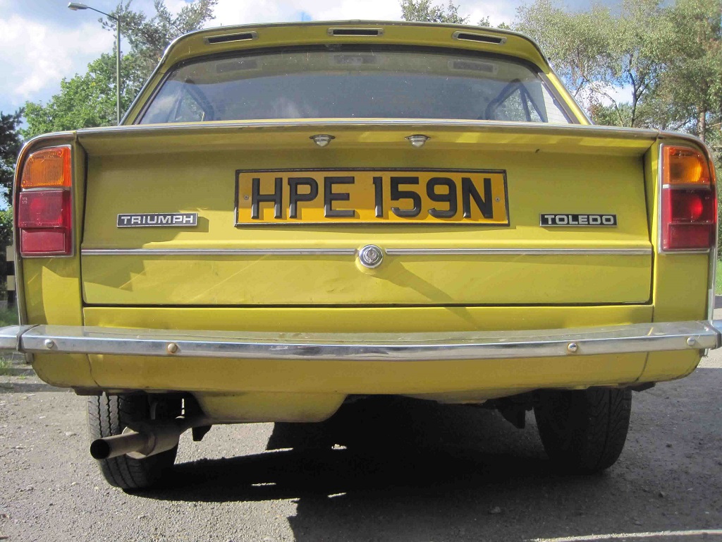

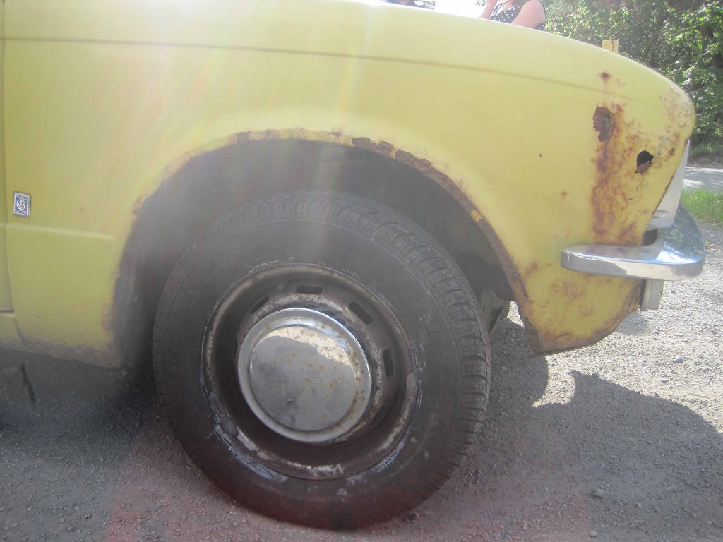

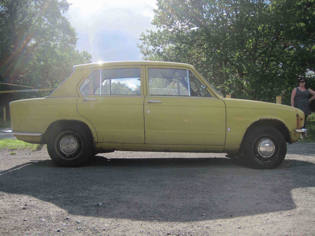

I would like to introduce you to Margarita Toledo! She is a 1975 Toledo with about 76,000 miles on the clock with just two owners. She was about to hit the scrap heap which I just couldnt allow....
The engine needed a little TLC and she failed her M.O.T due to her flexible brake hoses...But that is about it....I have replaced her tyres with new /old ones and she is about to get back on the road.
However! As you can see from the pictures she is in need of a good clean and T-Cut and there is a slight cosmetic rust issue. To which end I am a little out of my depth!
I would be grateful fo any handy hints on the best way to treat the costmetic rust around all the wheel arches and also the front drivers wing and the panel under the bumper. I am on the hunt for two panels and a recomended bodyworker...as I thought that it would be an sound investment for her future rather than treat/fill/sand and paint.....

Well done on saving that one. Hopefully a lot of that rust is just on the surface, and will just sand off.

The majority looks to be surface rust, the scab on the nearside front wing though has come from the inside so likely will go to a hole when sanded or picked and will need a plate letting in. The lower valance looks to be the worst panel and again some of these scabs will likely hole. The rest needs grinding back, some will be quite deep and cause pitting in the metal surface. You need to get to clean metal which isn't always possible with pitting without taking too much metal away, so buy yourself some Jenolite rust remover for these areas; go for the liquid rather than the gel and be careful, its quite a strong acid. Once the rust has been removed, build the profile of the area back up with good quality body filler sand back to profile using progressive grades of wet and dry, finishing with a wipe of stopping, sand with very fine wet and dry paper and prime with grey etch primer. This will show any imperfections in your work which you may then readdress before finishing with top coat Mimosa. Most paint suppliers will mix the colour and put it into handy aerosols for you.

I can only echo the advice above. A good wire brush on a drill or grinder can get into some of the worst pitting. I find that a combination of grinder and wire brush is best. Jenolite is great stuff.
If any of this rust has come through from the inside, then you will also have to attack it from there, otherwise you will find your nice repairs bubbling through quite quickly.
