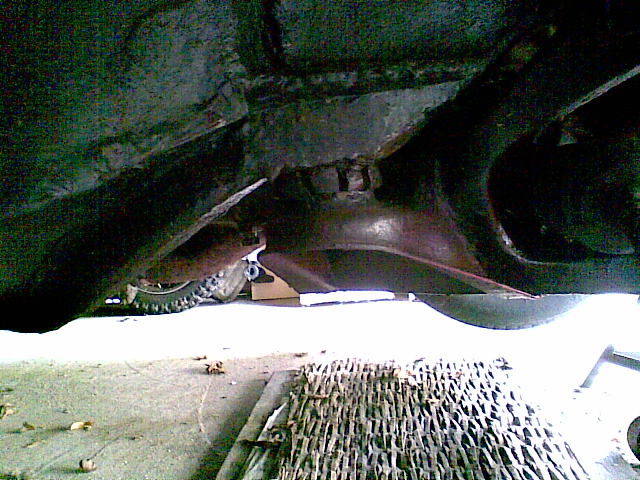

Thanks for the tip ian, :) today was my day off, so firstly i put the headlamps back together, all clean etc then checked out the indicator lenses new seals, all fine, then tackled the subframe mounts, well made a start :) jacked the car right up on the sills supported on axle stands+large chocks of wood, then with the jack, kept the support under the subframe while i undid the 2 nuts at the front they came undun quite easily to my surprise :shock: just had to hold the bolt under where the battery sits, these mounts look fine its the rear ones i am concerned about! thats as far as i got really as i hadnt got a deep socket for undoing the rear ones.. cup washers you say? is that where the nut is sitting sunk down inside? also what if the nut just spins on the drivers side next to the steering knuckle how on earth do you get to hold the bolt from the top if you see what i mean :wink: Ok the passenger side looks pretty simple because if this decides to spin you can hold the bolt, under where the heater motor is.
Here is a picture of the rear mount

It is possible to get a spanner on the bolt head of the rear driver's side. I think I managed it with a normal spanner but you have to get the steering linkage in the right position.

#5 Post by sprint95m »
nitram wrote: the rear ones.. cup washers you say? is that where the nut is sitting sunk down inside? also what if the nut just spins on the drivers side next to the steering knuckle how on earth do you get to hold the bolt from the top if you see what i mean :wink: Ok the passenger side looks pretty simple because if this decides to spin you can hold the bolt, under where the heater motor is.
You do need a deep socket for undoing these nuts.
An assistant to hold a suitable tool on the bolt is handy, although the last time I had to do this I managed myself. A socket connected
to a Tommy bar is useful here, I think I used a very short extension too. All 1/2" drive.
These bolts can be very tight. A breaker bar is a good idea.

#6 Post by Jon Tilson »
I've taken to using the deeper polybush mounting and a flat washer that does away with the cup washer at the back.
Ive lost 2 cup washers in active service now.....they rust out under the nut and WILL drop off and drop the sub frame, which is NOT funny.

#7 Post by nitram »
thanks for your replies, wont be till the w/end before i have another go :) Just a quick word about that rear mount from the pic and how perished it looks , that has been like that from when i bought the car back in 2006 so should it have passed the m.o.t like it was each year?, :? its just bugged me in the latter years when it dawned on me how bad it was or am i being to picky, just hope it comes apart ok an that the body is sound where the subframe joins :roll: (rust)
