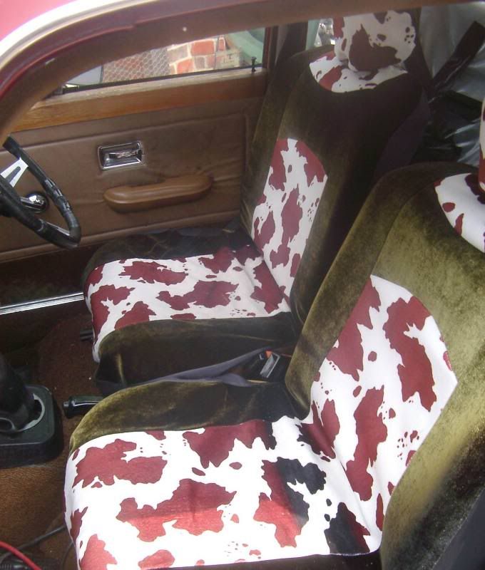

Adam,
buy these, I only have one set, so you will be able to distinguish between your cars forever.
I travelled on them for 100 miles and the velour is very comfortable!!
