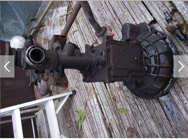

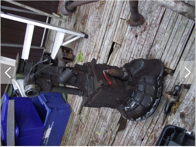

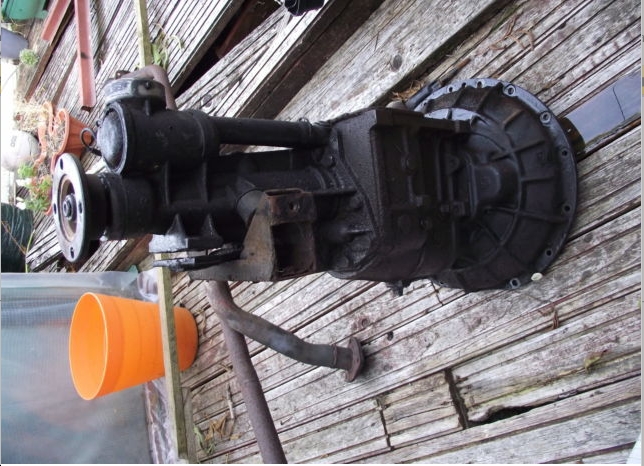

Hi Guys thanks for all the advice, I will try to source a single rail box. One has appeared on Ebay from my town and the guy says it will fit a midget or 1500 spitfire, but is not sure about a dolly.
Thanks
Re: Dolomite gearbox
#11 Post by Jon Tilson »
That will do the job and you can easilly swap your gearstick.
